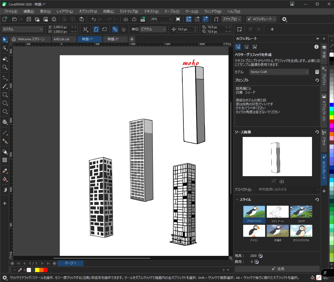

Hi everyone,
Following up on this 3D building discussion, I wanted to share a very effective workflow breakthrough for texturing and surfacing 3D buildings in Moho.
Even with tools like MeshWeaver—which automatically projects 3D prop vertices onto a camera-facing 2D Smart Warp mesh so you can map flat artwork onto 3D surfaces—the biggest hurdle has always been creating the building surfaces themselves (drawing hundreds of perspective-aligned windows, complex architectural facades, and shading by hand).
I tested a new pipeline combining MeshWeaver with CorelDRAW 2026's newly updated Text to Vector AI (released on Sept 15th), and the result is incredible:
The Pipeline:
Base 3D Block in Moho: Set up your simple 3D building block at the camera angle of your scene (see the top-right box in the attached screenshot).
AI Vector Surface Generation: Use that render as the reference/source image in CorelDRAW’s "Vector Craft" AI generator with a prompt like:
"skyscraper, black and white shading, modern hotel facade, square gray windows, keep camera angle".
It instantly creates detailed, clean vector building facades that strictly match the camera perspective and angle of the Moho block.
Smart Node Reduction: Use CorelDRAW's native "Reduce Nodes" feature to eliminate excess points, keeping the vectors crisp and ultra-lightweight.
Mapping via MeshWeaver: Export as SVG, import into Moho, and drop it onto the MeshWeaver Canvas. MeshWeaver automatically deforms and wraps the vector facade onto the 3D building's surface with zero tracking jitter and flawless 3D perspective synchronization.
Instead of spending hours manually drafting windows or dealing with heavy raster textures, this turns building texturing into a matter of minutes—producing clean, editable vector surfaces that stay fully animatable in Moho.
Hopefully this helps anyone looking to populate dense 3D cityscapes in Moho!
