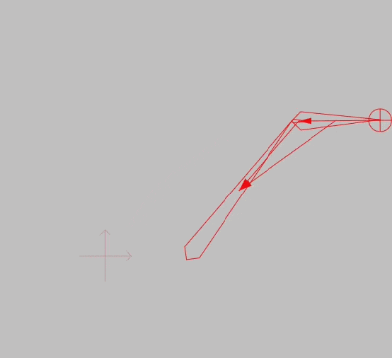

I'm not sure what you mean. I animate Independent Angle all the time, typically for foot setups. For example...
In the above, I'm using Independent Angle to keep the foot bone level with the ground, but I'm also keyframing the rotation of the bone after the foot is lifted off the ground.
What Independent Angle does is it puts a bone's rotation into world space, so it effectively bypasses the rotation of parent bones. It should not prevent you from keyframing the bone.
Are you not seeing this behavior?
