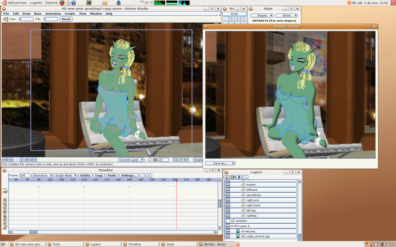

Hi montblankdesign, Happy New Year for you, too!! Nice animation.
But did you notice the gap on the background when the camera looks to the cyan devil woman? Why?

I moved the camera. I am still learning. I have been frustrated why this bg seems to rotate to the camera at this camera move( i discovered this by looking at the top view). I did not edit this short but merely used the camera for the shot change. I have been unable to get the bg to keep the same 3d relationship, and I haven't been able to figure out how to post the problem as a question. If you would like to take a look at it I have posted it on my public folder.

It is just a bug. It doesn't render as it is shown in the screen.
You can post it at the bug section just telling that frame 169 doesn't render as it would.
It seems to have a ghost version of the room just a frame before.
I don't know a work around for that.

Montblankdesign, double-click the SD_night_skyline.jpg background image layer and uncheck "rotate to face camera" and that will solve your rotating image problem. You must've checked that on by accident at some point.
Regarding the particles: In order to remove the black fringe around the orange and blue lights and make them brighter, double click the orangelight.png and bluelight.png image layers and change the "layer blending mode" to "screen". The greenlight.png image looks best because it is already set to screen, but the other two aren't.
Also, Genete the render on frame 169 is not a bug, if you check the settings for the "sd set.png" background image, he has motion blur turned on, which is an effect that only shows on render and not on stage.
