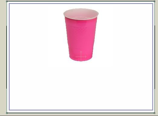

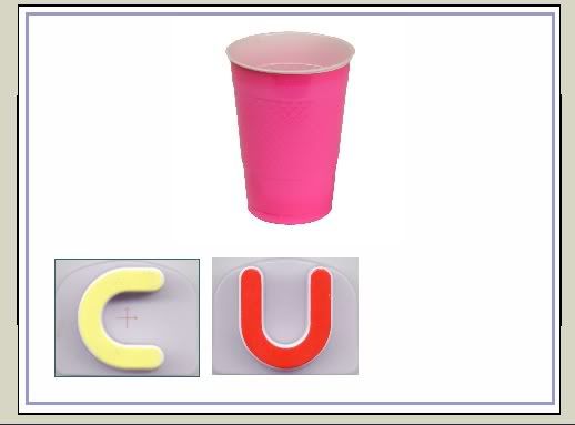

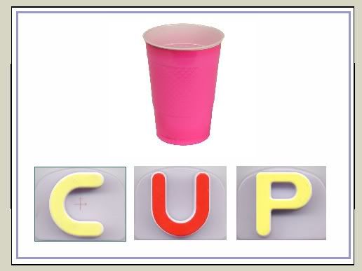

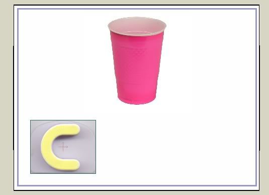

I'm missing something. I've been at this for days now and I can't get the time line to show what I want it to when I want it to.
I'm using 6 Deput
This is what I have now:
I turn off all the "eyes" and this is how I want it to play out:
But for the life of me I can't figure out how to get images not to show until it's their turn. I move the time line then I click on the little eyes, then I click the image and a little blue dot shows up on the time line, then I go to the next image and I click the eyes so the image shows, then I click the image and a little dot shows on the time line and so on, but when I run the time line from the beginning the letters are there all the time. When I go to the top of the time line none of the letter images should show.
