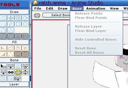

It is at frame zero. The RELEASE LAYER option is grayed out too. -_-
See...this is what my options look like in the bone area. -_-[/img]

Can you select not the bone, but the layer rather and see if the options are available to you there? A full screen shot would be very helpful here if you want to do that perhaps?
Posts: 7045
I can see from the screen capture that your bone tools are "active" which means you have a bone layer selected. The release points menu option won't be available since this is not a vector layer. Also you can't release a layer if that bone layer is not in another bone layer. If this is the TOP layer then there is nothing to release.
If you want to release points on a vector layer then you select the VECTOR layer that has those points and use those menus. That layer must be in the bone layer of course. The help files and tutorials that come with AS 5 and 6 have the steps and instructions to do this. Version 5 instructions were not as "thorough" but still do the job.
To bind points to specific bones you select the bone first then select the Bind Points tool and select points. THEN click the "bind points" button or press space. To unbind points select the points that were previously bound to a bone and in the Bones menu choose "Flexi-bind points". If you don't want the points to be influenced AT ALL by any bones then select the points and choose "Release points" from the menu.
To bind an entire layer to a bone select the layer then select the "Bind Layer" tool. THEN click on a bone to bind the layer to it. To unbind a layer you just select the bind layer tool and click on the screen so no bone is highlighted or you can just select "unbind layer" in the menu.
