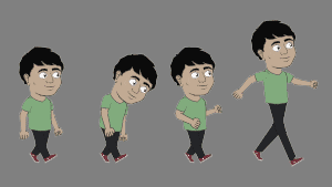

I'm working on a script to let me save and load skeleton animations so I can reuse walkcycles and stuff on other characters (with similar bone layout).
So far it's going pretty well. Example gif below:
I saved the animation of the character on the left and loaded it onto the characters on the right. (the reason the front arm deforms on the middle character is I used some point animation on the original characters arm which, obviously, isn't saved/loaded)
The way it works right now is the script only saves animation from named bones and loads it onto bones with the same name. So for example, these three characters front arms consist of bones named "upper front arm", "lower front arm", "front hand" and so on.
It will save animation between the start and end frames of the projects and right now it can only save/load rotation and position, so no keyframe interpolation, cycling, scale e.t.c.
Now before I spend more time on this I want to make sure that no such script has already been done. Has it? Because this could take some effort to make really good and I'd rather not do unnecessary work.

Well, I managed to modify my script so that you can load rotations and positions relatively instead of absolutely:
As you can see the character on the right has a crooked spine and the arm is way off to the right.
I did it in my script because I haven't dared to take on the task of understanding Vern's massive script yet, but now we know it works.
