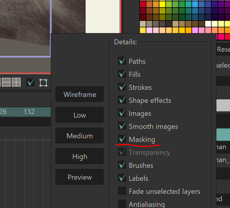

Posted: Tue Nov 08, 2022 7:36 pm
by alanthebox
and just to confirm, you have masking enabled under display settings, correct?

Re: mask failure
Posted: Tue Nov 08, 2022 9:31 pm
by RigTheory
THAT WAS IT!!! :D
THANK YOU!!!!! :lol:
