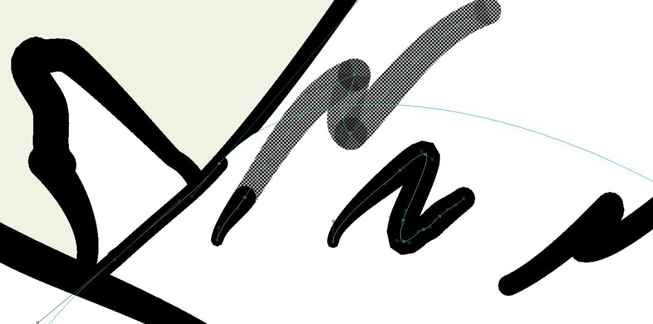

And can someone explain the layering effect in the attachment? I don't quite understand how some lines are arranged on a single layer. Some times they're behind a fill and sometimes they partially break through like the screenshot. Image
If you use the direct link, the image will show on the forum.
The shapes on a single layer have a shape stack order. You can change that with the arrow keys using the select shape tool.

Re: the artwork, it looks to me like you have two different stroke shapes on the same path, and the shorter shape is in front of the white fill shape while the longer shape is behind. To correct this, use Select Shape to move the white shape behind the two stroke shapes (or whatever arrangement you prefer.) You can move the shapes up and down using the Up/Down Arrow keys; use Shift Arrow Up/Down to send the selection to front or back.
When working with shapes, it's important to understand that shapes are separate objects from paths/curves, and you can have multiple shapes sharing on the same paths while also using points in completely different paths at the same time. It might seem confusing if you're a new user but this is a very powerful feature in Moho. BTW, it's also possible to animate the stacking order of Shapes. You must first enable this feature in the Layer Settings to do that, but don't enable this feature unless you intend to use it.

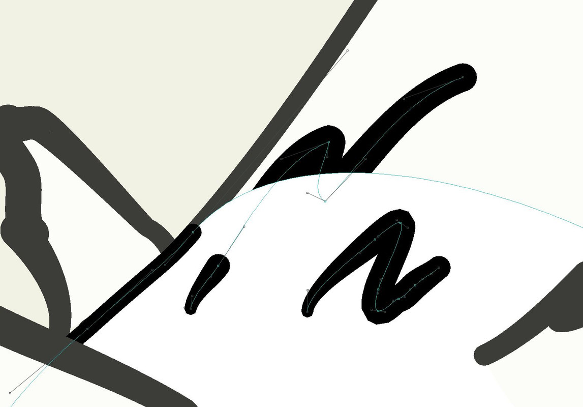

Greenlaw wrote: Fri Nov 18, 2022 12:06 pm BTW, it's also possible to animate the stacking order of Shapes.
That sounds perfect. I have some areas where limbs need to wrap around or cross over body parts. From my image and what you have explained I assume this stacking order can be used to pass a curve through a layer based on points?

FHUGO wrote: Fri Nov 18, 2022 4:08 pm That sounds perfect. I have some areas where limbs need to wrap around or cross over body parts. From my image and what you have explained I assume this stacking order can be used to pass a curve through a layer based on points?
Yes, although for moving limbs in front of and behind the torso, I like using Animated Layer order instead because it's easier to move the layers up and down inside the Layer Window than it is to move shapes inside a single layer. To do this, you need to enable Animated Layer Order from the parent Group's Layer Settings window.
