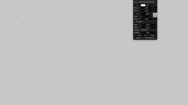

I'm getting some weirdness when trying to use the tool. Firstly it seems that it always adds the first point in the middle of the canvas and secondly, when creating beziers, there's mainly glitching happening:
I'm on a M1 Pro Macbook with the latest macOS installed. I tried different viewport settings (GPU on/off, etc.) but all had the same effect.

JoelMayer wrote: Mon Feb 13, 2023 11:36 pm I'm getting some weirdness when trying to use the tool. Firstly it seems that it always adds the first point in the middle of the canvas and secondly, when creating beziers, there's mainly glitching happening:
Oh, I'm sorry. I don't have the opportunity to test on macOS.
Can you temporarily disable all other custom scripts except for this one to make sure that the problem is in this script?
