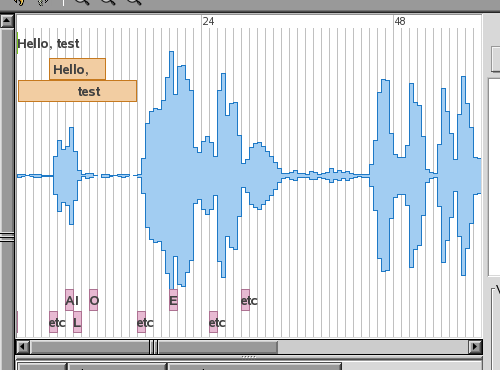

Before drag'n'drop the display looks like this:
And after:
Python 2.4.1
I am using papagayoMOD 1.3.4 src.rar
The play buttons were hidden because I forgot to copy the rsrc subdirectory from the original papagayo (the icon pngs are there.). I am not using unrar so much and I invoked it with "unrar e" instead of "unrar x". So it uncompressed everything into a single directory. But now it seems it's OK.
And after:

From what i have seen in the drag-n-drop module there areSuSE Linux 10.0, gnome wm
Python 2.4.1
some object methods that have not been implemented in
the linux release of wxPython, even though they are
documented as if they are.
In the 1.3.4 version of pMOD I used custom attributes to go around this,
and it surpises me that it still doesn't work
(even though it works fine under windows)
Could you please post the error log.
I do not have linux, so if you help me fix this
I will add that local dictionary feature you want.
Thanks.
