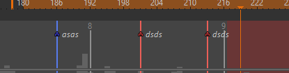

Daxel wrote: Sat Aug 21, 2021 3:54 pm
davoodice2 wrote: Sat Aug 21, 2021 9:30 am
yes that's it. some thing like this but for marker.
It looks fairly similar
https://1drv.ms/u/s!AiyKCw6Xey5TgZUboLs ... w?e=m3ilbZ
By the way, to extend the marker dragging it it's not alt+right-click, but alt+left-click.
how do you make colors?
Posts: 1092
Re: LK_SwitchMarkers (Show switch sub-layer names on timeline)
davoodice2 wrote: Sat Aug 21, 2021 11:33 pm
Right-click on any keyframe or marker to open a panel and there below many options you have one to choose a color. In spanish the option is called "Etiqueta" that means "Tag" I'm not sure why, maybe an error on the translation.
davoodice2
Posts: 397
Post by davoodice2 »
Daxel wrote: Sun Aug 22, 2021 1:26 am
but just change color of key or marker. background of timeline dont change for me .
Lukas
Posts: 1353
Joined: Fri Apr 09, 2010 1:00 am
Location: Netherlands
Post by Lukas »
davoodice2 wrote: Sun Aug 22, 2021 2:18 ambut just change color of key or marker. background of timeline dont change for me .
If you change the Hold Duration on a Document Wide Marker it will color the timeline.
davoodice2
Posts: 397
Lukas wrote: Sun Aug 22, 2021 2:35 am
very nice. thank you bro. thank you daxel too.
