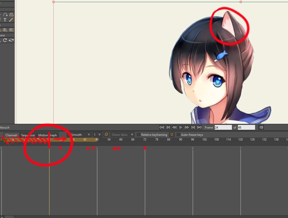

Hi there. I know that this question is very simple, but I don't know how to do it.
Sorry for my english.
How to make layer with mesh and bones appear on certain moment in timeline, like when you move a bit your timeline and at this position adding some new image, so this image will show in animation only at that moment where I added it, but how to make it appear and disappearing more easely way and with any layer? Thanks a lot!
Like that:

simple answer:
in the layer properties tab there's a "Compositing effects" section with a "Visible" checkbox.
on frame 0: make sure this box is checked.
on frame 1: uncheck it
on (e.g.) frame 24: check it again.
(repeat the last two steps with any frame number pair - e.g. 50/75 - to turn visibility off/on again...)
If you need / want a more sophisticated approach for whatever reason (e.g. you've used the sequencer) just say...
hope that's helpful...

Thanks a lot! It's helped me very much mate!
