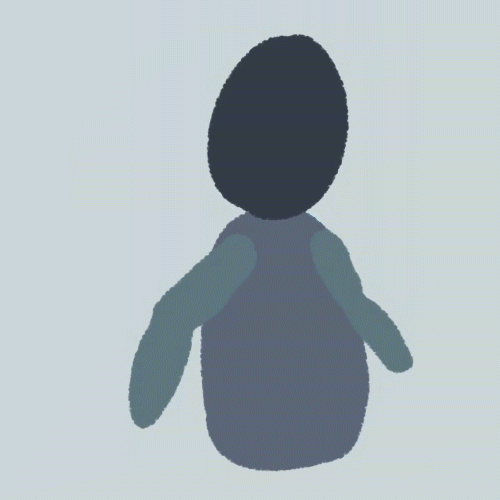

Although I haven't experimented with it myself, I'm wondering if you could create looping cycles for each element of a rig. For instance, isolate each facial element on a head rig as frame by frame layers, draw 3 keyframes per layer, and then create a looping cycle for each element. This would probably give the character a more hand drawn feel, without having to frame by frame the entire animation.
Worth a shot!
Edit: I threw together a super rough/quick test just to see if this method is possible. It looks like it is! I think the effect would be more convincing if I had done a better job tracing and possibly added more frames.
Worth a shot!
