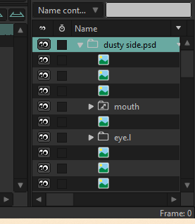

I imported a PSD file saved as PSD from ClipStudio. The file imports and all the layers are correct, but the layer names are not importing. Is this a bug, or am I missing something. Thanks.

I seem to have it sorted now. In the "eye.l" folder there were some unnamed layers, so MOHO didn't like it. Once I sorted that, all seems to be working.

Ah, okay. I guess that makes sense since Moho now uses the Layer name as well as Layer ID. Previously, Moho used only Layer ID to keep track of layers, which led to some update issues when adding, deleting and merging layers in the paint program. The new system works more reliably in these situations.
I'll have to check but Moho probably prefers unique names to help it sort layer changes made in CSP (or whichever PSD compatible paint program you use.)
