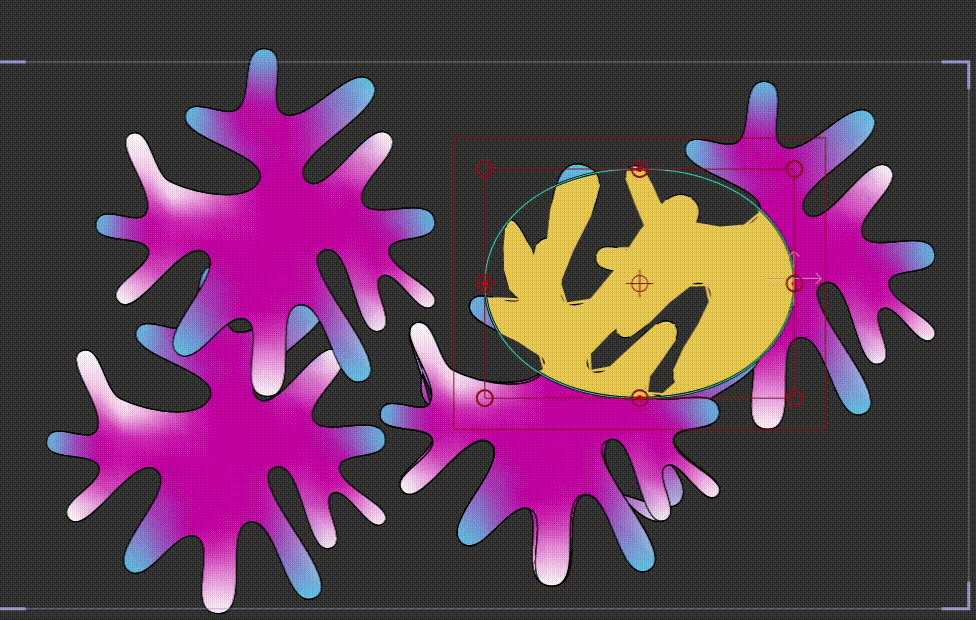

The 14th version is a brand new one, with some areas that need improvement.
For example, adding masks to a model can become very sluggish. If the model contains colored nodes, it will become more sluggish.
I don't know if other users have encountered this issue
:shock: I hope only I am troubled by it.

I've been working with Moho 14 a lot, and performance have been great here, using all kinds of nasty complex nested masks so I guess something specific is happening there. Let's try to pinpoint what the issue is so you can report it in a way Moho devs have an easy time fixing it.
Does this happen every time or just in that specific moho file?
What do you mean by adding masks? any type of mask? Is that a vector, bitmap or hybrid model?
Where do you notice the slugginess?
What do you mean by colored nodes? Colored vector points or colored keyframes? I think colored vector points are not a built-in feature.
If I remember correctly you are on windows, right?
Can you share a file that we can take a look at?

:shock: After the screen turns white, moho14 freezes and then the program crashes :shock:
I can currently only make shots in 13.55 that include masks.
I use moho14 basic functions. No external plugins.
Full vector model, no reference to pixel images or patterns.
This kind of lag and crash only occurs in complex moho files. (Especially models with lots of colored nodes)
I use win10 system, sorry I can't share the project files, this is a commercial project,But I created another engineering file with a similar problem,I can't open it with 13.55, as opening this file on 14 will crash. :cry:
https://drive.google.com/file/d/1vMXC2g ... share_link

:cry: Yes, you guessed it right. In this model I use colored nodes a lot. The art effect is very good, but 133.55 will be a bit laggy. And 14 is a complete meltdown. Every time.

Ah, color points! Sorry I forgot they exist. I should use them more, they are pretty cool. And your drawing too, I like that style.
Thank you for the information, I understand now and I can confirm it slows down very much here too.
Disabling the display of shape effects makes the performance ok again. The effect on the performance seems to be related to the amount of shapes and color points (tested it with less shapes and only one color point and the performance was good, so it seems to be an accumulative effect on performance.
Hope it can be improved a lot, but I wonder how much since color points look like a performance heavy feature anyways but I hope it can be improved.
