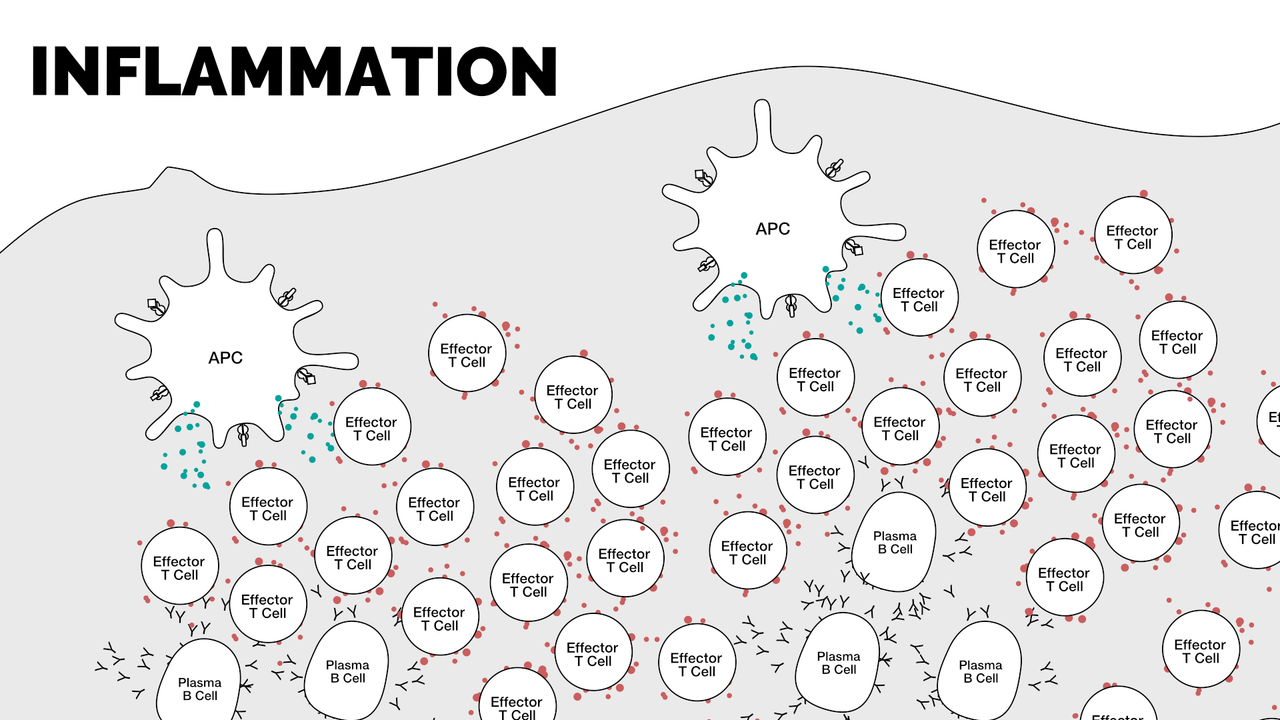

And if you're interested, here's an image from my storyboard. FYI, Effector Tcells, are regular Tcells after they get activated by the macrophage (APC) presenting outside matter. They multiply, get crazy etc.. Just so you get a sense of the challenge. Simple shapes, but numerous, and some animation involved.
Posts: 3850
Joined: Wed Feb 16, 2011 8:12 pm
Re: Liquid shapes lose their effects?
seriously interesting subject area and challenge! Good luck with it!
