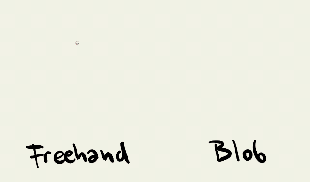

After doing my FBF Tutorial i've been thinking a bit. In some other vector software you actually preferably sketch your rough with the equivalent of a Blob Brush (just called brush most of the time) and use the Freehand (or Pencil) tool to clean it all up with a solid centerline.
I really like the Behaviour, Speed, Ease and nice erasability of the Blob Brush. There's only ONE thing that would need to change for it to be perfect: the way strokes are previewed when drawing before letting go of the stylus.
Personally i often just do the Adam Phillips (Brackenwood fame) method of a vector rough brush and take a red or a blue color and make it transparent. With that i can "build" my drawings a bit more. The Freehand tool does this very nice however the Blob Brush previews strokes much more opaque until you let go. This doesn't seem like a big deal probably but for a nice sketching experience it really would help to have the Blob Brush Preview it's stroke a bit more nicely like the Freehand.
A Gif to illustrate what i mean better both have the same color and opacity settings:
Hope this makes sense and thanks ^^

I don't think that's not going to happen any time soon, because of the way the blob brush works. It initially draws a series of 'blobs' following the draw path. These tend to overlap and hence darken/opaque-kerize the initial paint 'stroke'.

SimplSam wrote: Wed Oct 16, 2024 7:20 pm I don't think that's not going to happen any time soon
Double negative! So... we gonna see this next week? :P :lol: Yea you're probably right, i just wanted to mention it. Perhaps it would be good then to think about a replacement for the "blob" brush and just have the pencil and brush tool we're used to from every other vector software.
