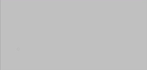

One of the things i really wish for Moho's freehand tool is a more "standard" brush stabilization option. Atm, Moho seems to somehow smooth out a stroke after it's drawn. Most art programmes simply kind of "delay" the stroke from the cursor while drawing. This leads to a much smoother experience because the brush that you lay down is also the one that you end up getting. With Moho it's kind of jarring that you lay down a stroke and then have to wait till it "gels" until you get the final result.
To compare here is how the stabilization looks in Clip Studio:

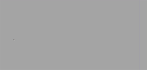

And here's Moho
Hope this makes sense. I'd recommend to the devs to test out the stroke stabilization in both Clip Studio and Toon Boom, both are excellent and a good point of reference.
