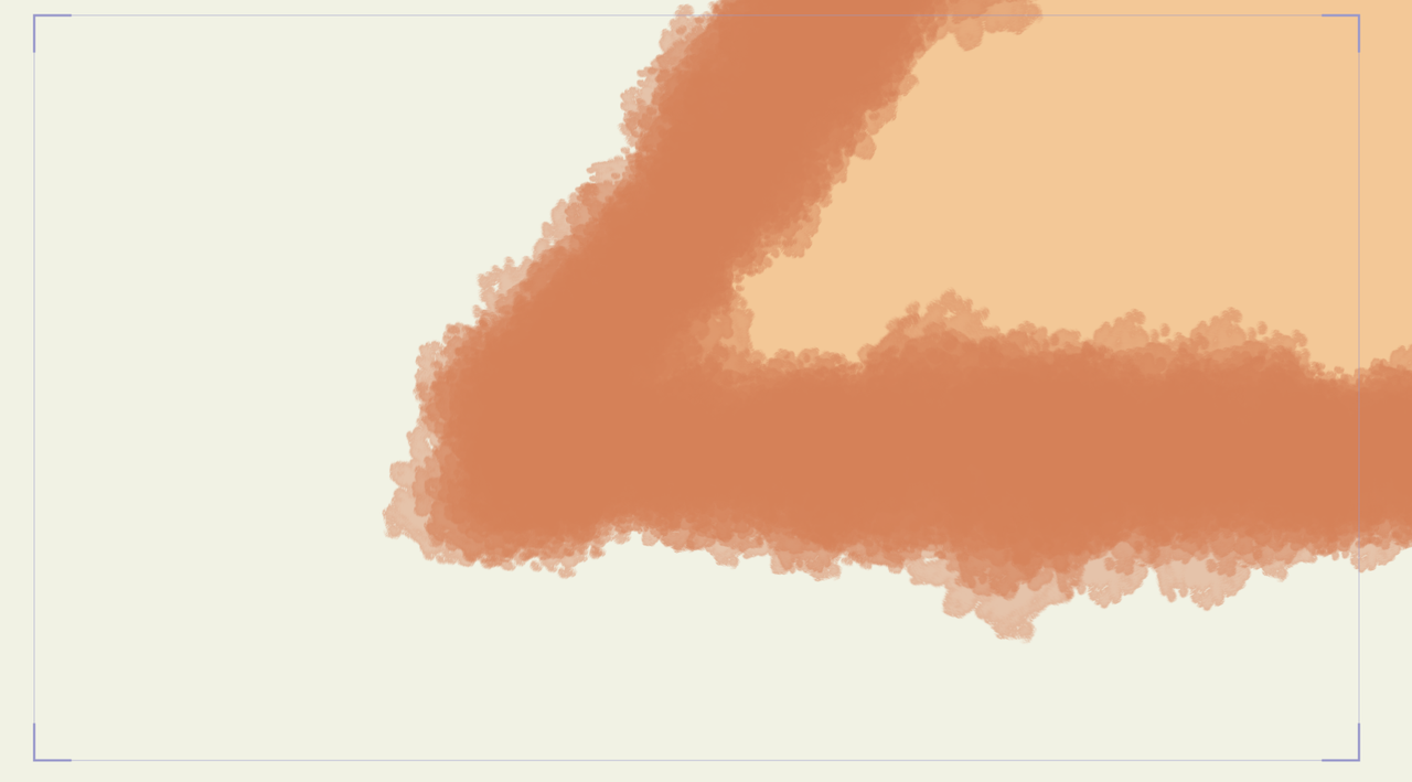

I'm testing out Modo at the moment and running across a visual bug that seems to occur on export. If I put a brush effect on a stroke, it appears to get clipped once the animation is exported.
To demonstrate, I've drawn a basic triangle on a vector layer in a new file. I've then applied a watercolour brush effect to the stroke of that shape:

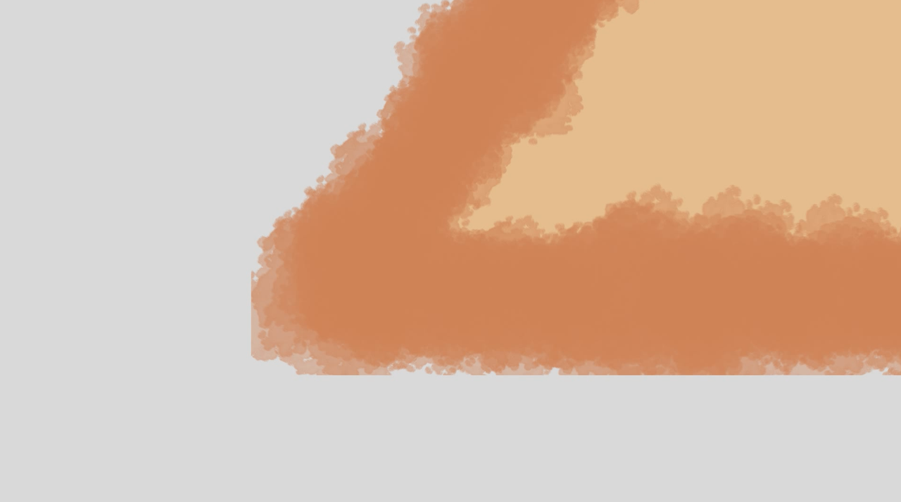

If the layer is selected, playback within Modo is fine - I've got line boil and various other settings on to give it a bit of randomness. However, once exported, the effect is clipped by some kind of invisible mask:

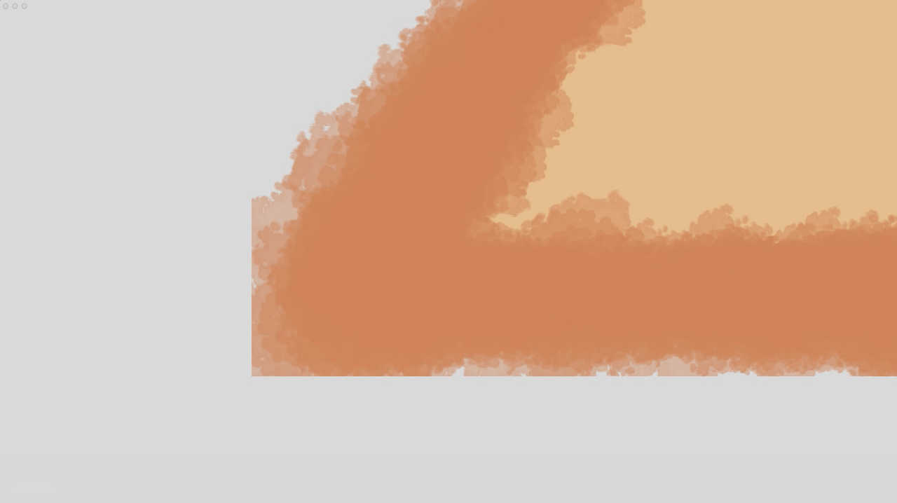

If I scrub through the render, you can see that the invisible mask stays in the same place:

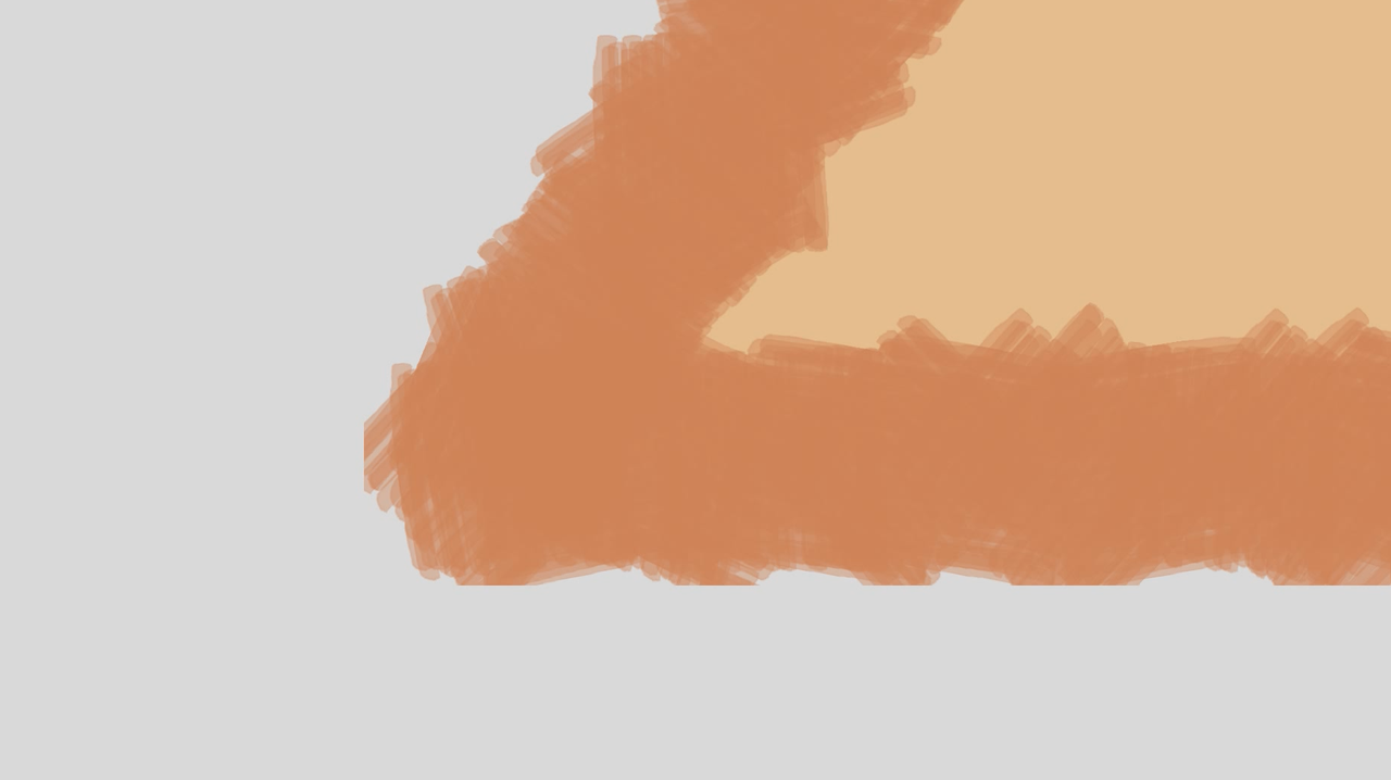

Nothing I do seems to have any effect on this clipping. Shrinking the size of the stroke also seems to reduce the size of the invisible mask along with it, so clipping still occurs (It's less noticeable at a smaller scale, but it's definitely still there). The invisible mask also doesn't seem to correspond at all to the frame that shows when you select the object in Modo (that particular frame is actually a lot small than the invisible frame). Some brushes are more affected by it than others - here's a different brushes with a less noticeable clip:
I'm not entirely sure how the brushes work, but given they seem to be a static image that's duplicated, scaled, rotated, etc along the stroke path, is there a chance that the frame these individual brush images are sitting are not rotating along with the brush itself? So rather than the brush image and its individual frame being rotated as one object, the brush image is being rotated inside a square frame while the frame itself stays the same?

Can you post a file with an example of the problem?

My guess: it happens because of its proximity to the project boundary.
Could you duplicate the project, double the project size, then reduce the content by half, and test again?

I've tried a few brushes with various settings (line boil, random etc ..) and close to the render area edge, but I can't yet reproduce the issue. As Wes has suggested, if you could upload a file...

The clipping occurs in the rendered file, not in the Moho interface. In answer to other questions, it happens regardless of how close an object is to the border of the project file (and honestly, regardless of how close it is, it should not happen anyway).
I will get a file uploaded when I’m back on my machine but I might do a full uninstall and reinstall first - I had previously had Anime Studio installed from way back so I’m going to try and purge my system fully of anything related to Anime Studio or Moho and try again.

Ah ha! Solved - it looks like some old installations of Anime Studio/Moho and their respective content folders were the issue. Went through my machine and purged everything I could find and reinstalled it all from scratch and I'm now no longer getting the clipping on export. It was probably an older version of a default brush that didn't work correctly.
Many thanks for everyone's assistance!
