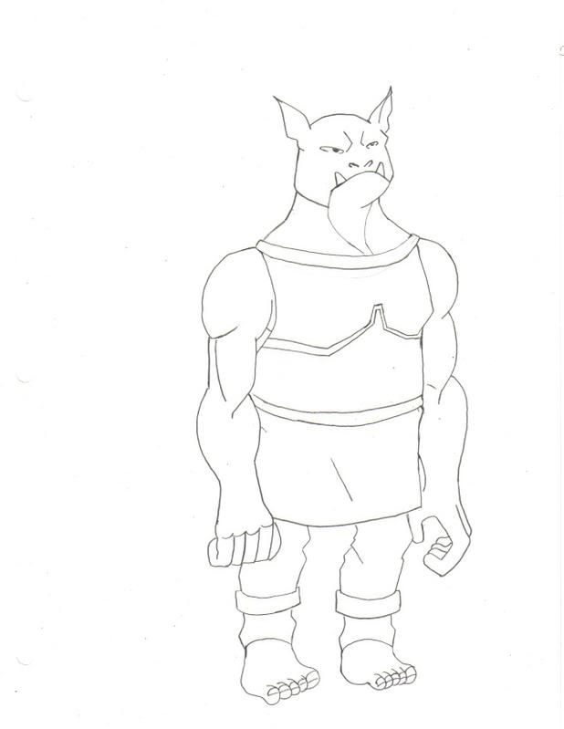

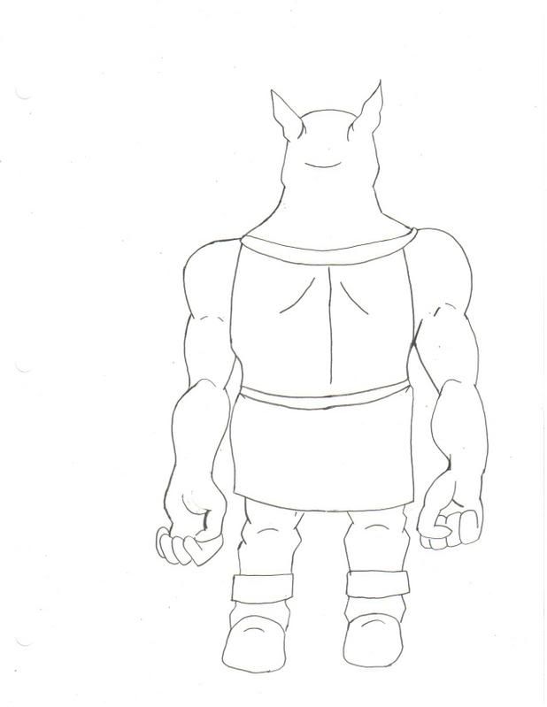

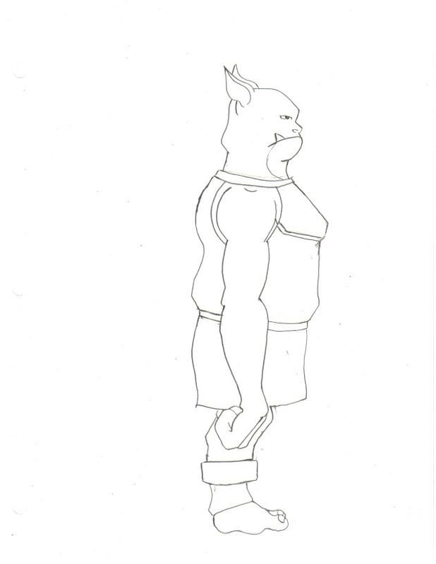

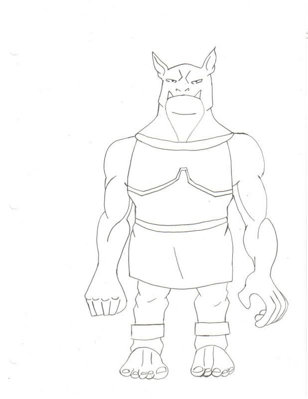

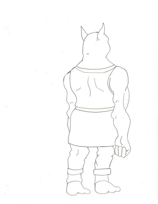

Great samples you did for a newbie in Anime Studio. I really like it.

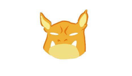

Here's an example:
layer 1
layer 1 copy 1 (breakdown 1 to layer 2)
layer 1 copy 2 (breakdown 2 to layer 2)
layer 2 copy 1 (breakdown 1 to layer 1)
layer 2
resulting animation
(source:
swithinterpolation.moho.zip)

Mind you, you don't have to use switch interpolation. You can also use bone animation. For some part of your animation, however, using switch layers may be the best solution, especially when a part of the body (or the whole body) changes perspective (basically, the part turns around an axis that is not perpendicular to the screen), and a previously hidden side comes in view. A head turn would be a perfect example, but mouth shapes as well (although those can be done with bones as well, if you set it up carefully).
