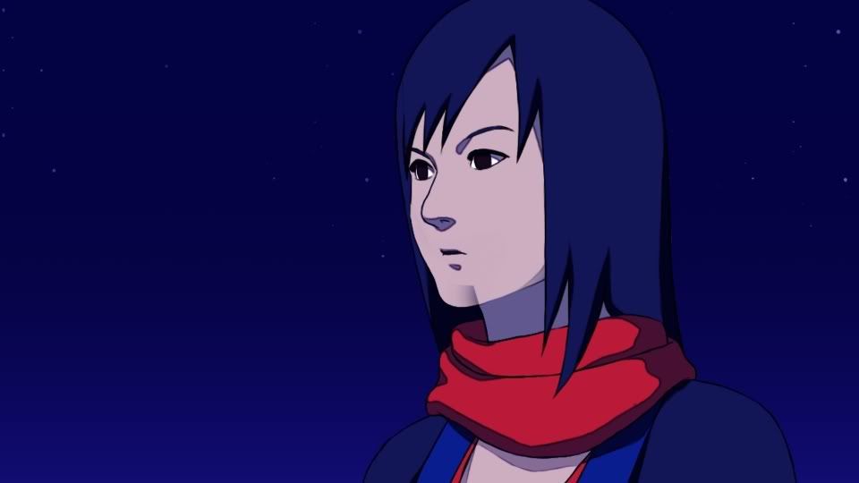

Thanks heyvern, I understand that masking it does help with the situation. However, that was only a basic of what I really want to achieve. I never meant for the crop image to be acted as a mask. I think you will understand it better with this new file.
http://herbros.com/mouth%20test.zip
When doing the movement of the mouth, I usually draw it move with the chin, but instead drawing the whole head, I cropped just the bottom half of the head to save a little time drawing. However, when rendered, there's the break of while area that bothers me. Is there a solution to removing this line, without having to draw the whole head with the movement of the chin, and without using vector? Or better yet, is there any way to render it so that the alpha would be perfect? I'm sorry if this is kinda confusing. Note that in compressed JPEG format, the break (or line) is not as visible but it is fairly visible when output to a TV screen. Any suggestion would be appreciated.
Posts: 3187
The crack looks to be the join around your mouth shapes... even though they arent visible in AS preview, the crack moves around to where your slices are joined...
PNG24 allowes for a gradient alpha - if you feather the join edges they will be invisible:
this is very rough obviously but you get the idea...
Also it could be because you are scaling up the slices bigger than their actual created resolution? i didnt have to test this but could be an issue...
By biggest reccomendation is to trace over your character in AS and learn its drawing tools - the render quality would be better, and you would have more shot choice over zooming in more than originally intended... also, you could create the mouth shapes with point animation so you have smooth mouth interpolation...
