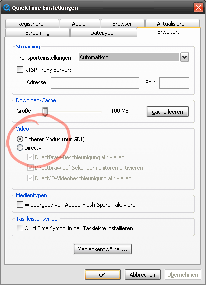

I´ve had sudden problems with exporting quicktime movies from Anime Studio Pro recently and couldn´t explain them as I didn´t have any problems a few days before that. I´ve read that some of you suffer from the same problem. Now I have a solution (it worked for me at least)
In your quicktime player settings - disable directX! I don´t know how the settings are named in the English version (extended/advanced settings?) but for the German version it´s these settings marked here:
With directX disabled I have no problems exporting quicktime movies out of AS anymore and my browser doesn´t crash anymore when playing quicktime movies embedded in websites (I´ve had the problem before...)

How the hell... well, brilliant you've found a solution. Anyone else can confirm this?
Does this solved the AE CS3 problem also?

cribble wrote:How the hell... well, brilliant you've found a solution. Anyone else can confirm this?
Indeed, this solves the problem I had. :D

Fantastic! That worked. I will have to go back and put that in my tutorial where I simply said that QuickTime crashes AS. A great piece of detective work.
