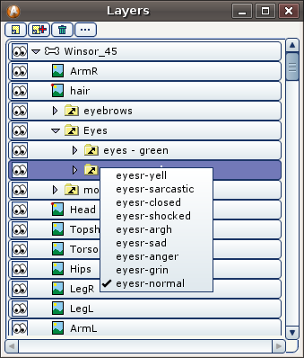

I've mastered lip synching with papagayo and switch layers, just the the tutorials told me, and I'm really happy with the results but I need to know how to move eyes.
I've created a switch layer for eyes (just like the mouth one) with lots of different expressions but I can't work out how to manually create an action line for the eyes switch layer. whatever I do just cancels itself
Can anyone talk me through this?
Thanks in advance :)
Sheik Yabouti
Do this:
1) Place the time cursor where you want to make the switch.
2) Right Click over the switch layer and select one of the options on the context menu.
3) Repeat 1 and 2 properly in other frames.
Alternatively you can press the Image button that supplies a popup menu in the tool options area that lists all the sub-layers of a switch group.

Post by Sheik Yabouti »
GOD that must be the only thinhg I didn't think of trying!!
must come from being a mac user :p
Thanks a lot
