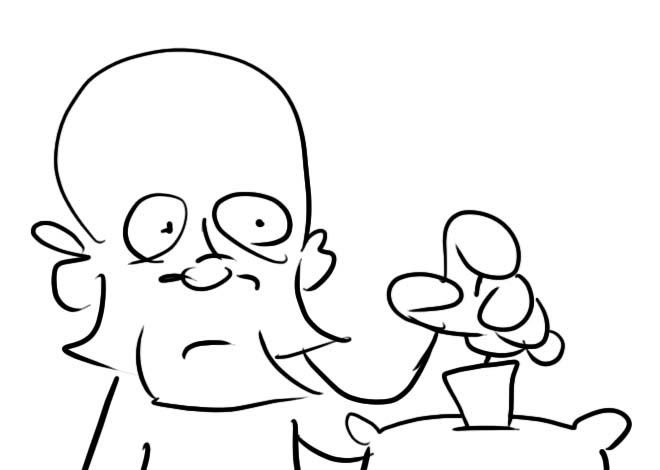

I'm doing an animation of a character pulling a tag off a pillow. My problem is: I want his pointer finger over the tag, and his thumber under the tag. I assume I need to make the pointer finger on a seperate layer that's above everything else, and have the tag above the thumb and hand. My issue is, how do I still keep the finger, hand, arm, and the tag (once it's pulled off and needs to move along with the hand) all smoothly animating together? If I try and use bones, won't the tag be in the way and get animated along with the hand and arm, since it's caught inbetween the pointer finger and hand?
Does this question even make sense?
Thanks for any help!

Just have your character and the prop all in the same bone layer. Create a bone rig for the character, and bind the layers to it in the way you like. Have the finger layer be separate, but bound to its bone as well.
Create another bone in that bone layer, but at root level (= no other bone is highlighted when you create this). Bind the prop layer (a group or bone layer or whatever) to it via layer binding. You could set the constraints of this bone to 0, so it will not move accidentially.

slowtiger wrote:Just have your character and the prop all in the same bone layer. Create a bone rig for the character, and bind the layers to it in the way you like. Have the finger layer be separate, but bound to its bone as well.
That helps a lot! I'll try it tonight!
This leads me to another question: I don't want the tag to move until the fingers touch it. At that point, I want the tag to move along with the fingers when they pull it off the pillow. Can I bind the tag to the same bone as the fingers later on down the timeline?

No, you shouldn't bind the tag to the same bone as the finger. But it's quite easy to make them both move te same speed. After all it's just a couple of frames. Have the start and stop keys of both movements in the same frames, and use the same interpolation - AS cares for the rest.
