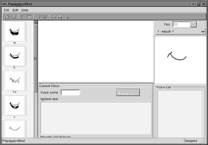

I made a fix for my window size problem. Maybe I made something illegal and I don't know how it looks like under other plafforms, so please check it. There are two separate problems under wxgtk and I am sure the problem is with wxgtk.
In the __do_layout of LipsyncFrame.py:
1 the vertical size of the whole contents (sizer_2) and
2 the vertical size of the left hand side phoneme list (sizer_2_5).
In some cases if I solve 1. the 2. is still goes out of the bottom of the window. It is strange because sizer2_5 is inside of sizer_2... I made the following solution for both of them:
In the line 481:
Code: Select all
sizer_2_5.Add(self.thumbnail_panel, 1, wx.EXPAND, 0)
And in the line 544:
Code: Select all
sizer_1.SetSizeHints(self.panel_2)
Sorry I don't know the wx protocol but this works.
- - - Fazek
nassosy
Posts: 59
Joined: Wed Sep 06, 2006 8:52 am
Location: Greece
Post by nassosy »
Fazek could you post an image of the pMOD when it starts under GTK?
Fazek
Posts: 246
Joined: Thu Apr 13, 2006 5:37 am
Location: Hungary
Post by Fazek »
- - - Fazek
