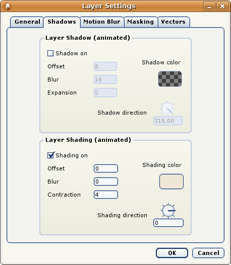

If you use the layer shading option with the following settings:
where the Shading color is the same than the inner color of your skin shapes and the Contraction is the same or bigger than the line width of your shapes. you can obtain this:
More thicker is the outline more bigger is the visible gap. But OK this is a workaround :).

Genete wrote:If you use the layer shading option with the following settings:
Hi Genete,
For some reason I am not able to achieve the effect would it be possible for you to share the example file you have created.
Joined: Tue Oct 17, 2006 7:27 am
Sure
http://www.darthfurby.com/genete/Other/ ... _only.anme
the effect is only visible when render.
-G

Genete wrote: More thicker is the outline more bigger is the visible gap. But OK this is a workaround :).
-G
Thanks Genete,
This a really cool workaround.
