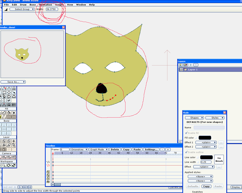

Astrocloud wrote:Image
Here is a very basic design. I am trying to use the Line Width tool to fill in the right side of the mouth. Only it is not working. No matter what I do -it won't fill it in. I circled some of the key indicators in red.
Try re-drawing it with the pencil tool.
Rasheed
Posts: 2008
Joined: Tue May 17, 2005 12:30 am
Location: The Netherlands
Post by Rasheed »
It is probably a shape stacking problem. Try raising the selected outline. You can select the correct shape as follows:
  • in the Image Select Shape tool, click on the position of the outline, and leave the mouse cursor in that position
  • using Control key and arrows Up and Down, cycle through the stacked shapes, until the outline is selected
  • Image Raise the outline until it is on top of the fill
