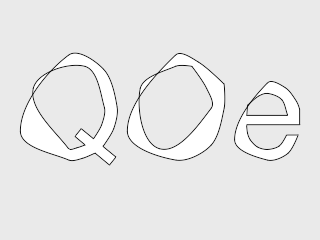

Lately, I'm rendering to see what certain effects look like, ones that don't show up in the regular design view (halo, for instance), and I see what I would call "corrupt shapes." Giant blocks of color where they aren't supposed to be, etc. Stuff that looks like it's fine in the regular view, then becomes crap upon a render.
Also having this problem with some text I just made with the draw/text function. Most letters are okay, but then a random "b" or an "n" will just look like triangles and circles.
I'm just wondering if the render is flawed, or if this is actually what I'd get if I started animating this stuff without fixing it first.

If you have complex shapes with cross section splines and lots of connection points that make up a shape and you delete points without looking at how the shape is constructed this can lead to those strange artifacts.
For example a distinct single shape is defined by a closed mesh with at least 2 points on a side ("corners" like a box. Minimum number of points for shapes that share an edge). Sometimes shapes share a side with another shape. If you delete points in such a way that causes that shape to not meet the requirements of a "legal" shape you can cause it to go wonky like that.
Another example would be a "checker board" effect. If you create a grid of points with the minimum number of points (single point at each vector crossing) you can't select alternating "boxes" in the grid to create a shape. Each checkerboard box has to be a distinct shape... or at least each shape has to be separated by more than those 2 points they share on a corner. Deleting point after creating a complex group of shapes could cause some problems.
Also lots of shapes that share edges and points internally and cross over each other... you start deleting points you can get some very strange results that AS doesn't like.
Now that I understand what causes it, it hasn't happened to me in ages and even when it did it was a rare occurrence. You CAN delete points but you need to keep an eye on what is happening to the shapes as you do it.
I'm not totally convinced that is what is happening in this case but without a file to look at or more info I can't say for sure. The text tool never gives me problems and would not create "bad shapes" since it is an "automated" process. However, I suppose a bizarre, or unusual font might cause this to happen.

Changing fonts seemed to fix the issue. It didn't seem to like the font I was using. I"ll get back to you on which one it was.

Some fonts can be very complex when they are converted to outlines. The text feature in AS has double trouble because not only does it need to convert to outlines it has to do additional conversion due to the difference between postscript curve descriptions and AS curves.
A very complex font with lots of weird curly cues and odd shapes could cause trouble.
If you can post the problem file it would be of interest to me. I like to see problems like this first hand to expand my experience and knowledge of how they happen and how to fix them.

Shape artifacts are rarely seen in the workspace preview. Hell, sometimes they aren't even visible until the character or shape gets moved just right during animation. As long as you can learn what causes these, you'll be able to avoid them in the future.

Well, regarding the fonts, the one that was giving me issues was very basic. . .haragino gothic regular w6 or something, and the new one ,cooper black regular, is also pretty basic. I'll move on to verdana if this one gives me issues.

for me it was B's (capital B) and N's. Actually, now that I think on it, on the shape I was recently taken surprise by, I may have deleted edges and then refilled it or something else. I'll post the file if I have further problems, but for now I'll just assume that I've set many booby traps for myself and see if I can track them down and disarm them.

If you select all but a few points of a shape you plan on creating and then zoom in or pan so that these unselected points are off-screen, it will allow you to make a filled shape. But because it is not actually a whole closed shape, it will cause artifacts.Can you elaborate on what you meant earlier by: creating shapes while part of it is offscreen
It may look like a fairly valid shape, just kind of ending at the last actual selected points used to create it. But animating these 'bad shapes' will usually show them to be bad.
