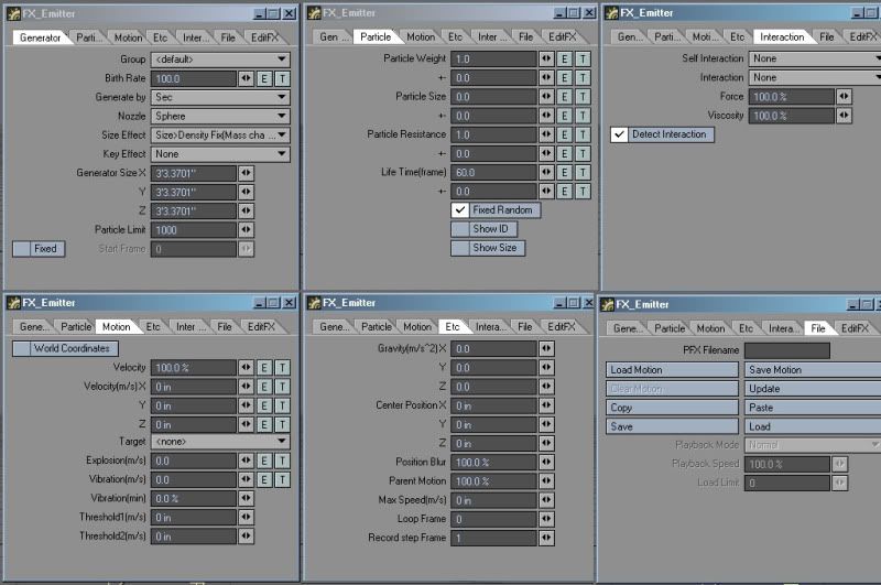

Here are some of the controls in Lightwave 3D's Particle FX. It's much different. (of course it's a 3D system with physics)

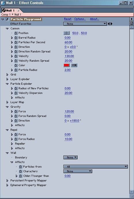

Here are the controls for particles in After Effects:

Ugh. These look ugly to me. I'm glad I don't have to deal with that, doing a movement by hand is much easier for me ...
And yes, GUI attacks like this support my decision not to do 3D at all ...

GUI attacks? I know it looks like a lot of controls, but they're needed.
