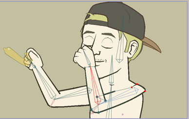

Let's say I have a character with his arm up like this:

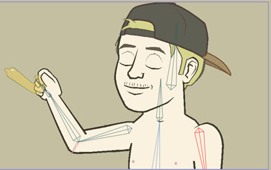

He lowers his arm, but now his shoulder looks bad:

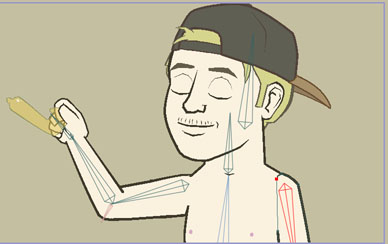

So I fix it with some point animation:

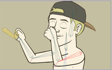

Then he raises his arm again:
If I copy the point keyframes of his shoulder from earlier then all is well:
But if I try to do it using a script, the points move to the exact point they were at frame 0, before the bone ever moved:
Is there a way to copy the keyframes like AS does but using script?
