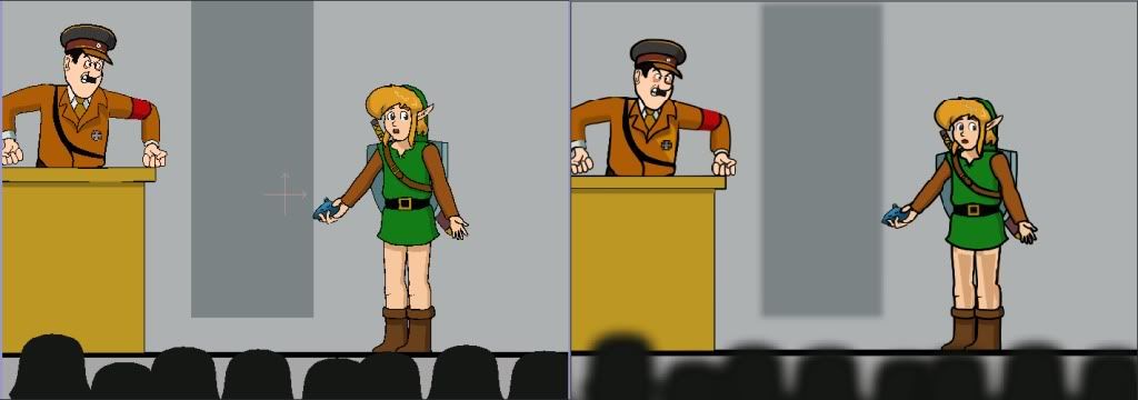

I did not put anything with that color in the animation, and it doesn't show up in the actual Anime Studio window, only when you click on "preview" or export the animation to the computer.
I DID however, find out that by deleting the black band running across the shirt, it goes away.
But I still can't figure out why it even appears there in the first place.
Here's a photograph of what's happening:
http://i759.photobucket.com/albums/xx23 ... 1286658722
The picture on the left is the regular Anime Studio window, while the one on the right is the Preview. Not only is there that yellowish triangle on the left shirt, but the shadows on the other guys' legs are all messed up as well.
I've tried changing the colors of everything, but even then the strange yellow triangle stays there. It only goes away when I delete the black band....and I can't even make heads-or-tails of what's happening to those shadows on the legs :S

This might be caused by two points or more that appear as one because they are coincident. This can cause some unpredictable shape formation. Try going through the shape point by point, delete the extra point, and remake the shape.
See this thread: Having some fill issues

Thanks for the replies, guys, but nothing has worked.
I've gotten the yellow triangle to disappear by deleting the band going across his chest, but no matter what I do the leg shadows stay jacked up the way they are.
I've gone through every point, none of them are overlapping.
(I guess I should mention that the leg shadows are drawn in as part of the vector. I didn't use the shading function.)

Well, I found a workaround.
I just deleted both the leg and the torso and redrew them. For some reason, the strange triangle didn't appear and the leg shadows were no longer distorted.
While deleting them, I couldn't see anything out-of-the-ordinary, and it's still a mystery to me as to why they did this in the first place.
But its fine now.
Thanks for your help!
But its fine now.
