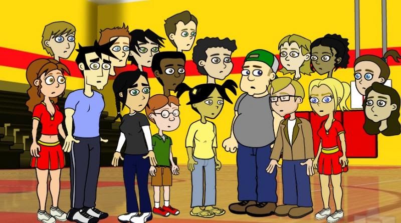

I'm still intrigued by the customization possibilities, but from a practical standpoint of what I'm trying to do I was looking for a quick way to use existing artwork to whip up new characters as I need them (there could be a lot, since I have a school of students and hordes of zombies.) But they are all "extras" essentially, so I wouldn't necessarily need them to be all that "good," or fully rigged and functional.
I had already been working from my own template of sorts and created a small cast of the main characters plus a small batch of extra (the floating heads):
Just thinking I could try to reverse engineer them and throw all their little pieces into CW, and get a little variation without having to build anew. If nothing else, it did seem as though it would let you use a bone layer for any of the switchable components, so that could save time by just throwing in some of varied eye/eyebrow rigs I've already made. Still be marginally better slapping something like that on whatever ridiculous face it puts together. Ultimately it all seems strongest just as a "Head Wizard" and then pop those suckers on a custom rig template as i have above.
