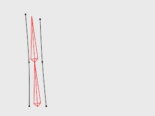

I thought I'd try to illustrate the reason for this decision. First, let's take a look at some curves in Moho. You could imagine these curves being part of a leg or arm. The dots on the curves are the control points Moho lets you work with, and the red structures are Moho bones (we'll see why I'm talking about bones in a minute):

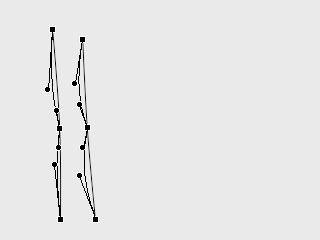

Now let's look at the same curves using an Illustrator-type representation. In the picture below, you see some extra control handles. Illustrator lets you adjust these types of off-curve control points, while Moho does not. These points still exist in a Moho curve, they're just hidden from you. The following picture was set up so that the Illustrator control points and the Moho control points are in the same positions - the Illustrator and Moho curves are the same:

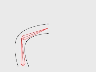

Now let's start animating - here's where things get messy. If we bent one of the bones, here's what happens in Moho. The Moho control points that you can see move with the bones. The hidden control points are adjusted automatically to keep the curves smooth. I hope we can agree that this is what we would expect to happen:

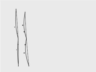

Hmm, that doesn't look so good. Here's what the Illustrator curves would look like after moving the bones. The Illustrator curves are the bumpy ones:
You can see what happened in this view showing the bezier control handles - the Illustrator curves lost continuity because they were bent by inconsistent amounts by the bones (because some control points are under the influence of one bone, and some by a different bone):
I don't know of a good way to avoid this problem using Illustrator-style curves where the user has complete control over the interior control points of each curve. One way to prevent your curves from getting lumpy or non-continuous is to let the software automatically adjust some control points for you - and this is exactly what Moho is doing.
