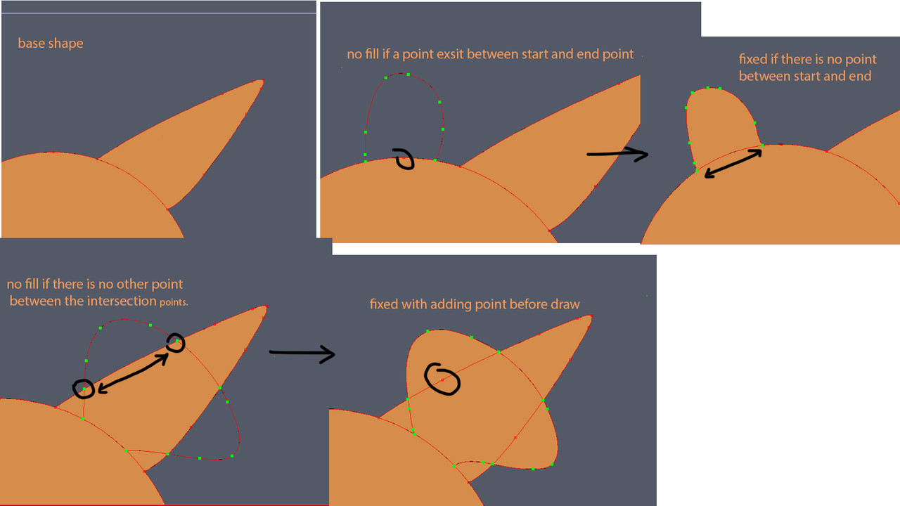

I think its about first and end point and some other things..
1 .There should be no other point between the first and last point.
2 . no fill if there is no other point between the intersection points.
I hope I was able to explain well.

Thanks for posting your findings! That explains some of this behavior more clearly.
