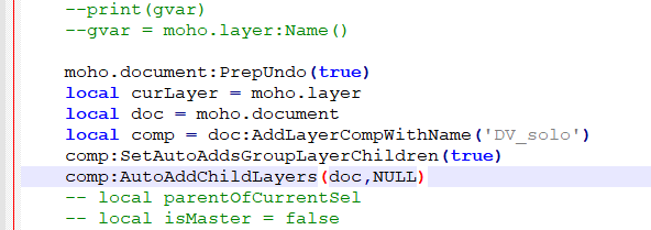

Code: Select all
	moho.document:PrepUndo(true)
	local curLayer = moho.layer
	local doc = moho.document
	local comp = doc:AddLayerCompWithName('DV_solo')
	comp:SetAutoAddsGroupLayerChildren(true)
	comp:AutoAddChildLayers(doc,NULL)
again when I use expose to layer comp in moho , all layers will be off

Code: Select all
	local dsfd = comp:AutoAddChildLayers(doc,NULL)
	print(tostring(dsfd))
print returns false

Code: Select all
	local dsfd = comp:AutoAddChildLayers(doc,curLayer:Parent())
I frustrated. I can pass every thing for arguments .no error. Just do Nothing. why doc should be one of args? do I access to other docs ?
