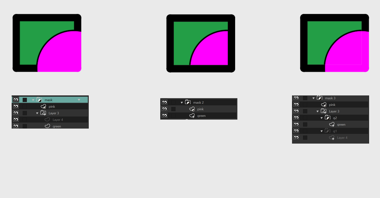

How do I ensure the mask excludes strokes for a vector layer inside a switch layer?
Please refer to image: https://i.postimg.cc/JzQWp8Vh/moho-masks.png
The middle image shows the mask with no switch layer, the green rectangle with option "exclude strokes" masks the pink circle perfectly, leaving intact the green rectangles stroke border. I want to achieve this, but where the green rectangle is inside a switch layer.
The left image show the mask as a switch layer, the green rectangle masks the pink circle but there is no option on the switch layer masking panel to select "exclude strokes" so the stroke border is destroyed. (The switch layer is set to "add to mask", the green layer inside it has no masking tab available.)
In the right image, I placed the green rectangle mask inside a group within the switch layer, so that the green rectangle vector layer inside the group now gives me the option "exclude strokes", but unfortunately it is ignored with the same results. (switch layer set to "add to mask", group q2 inside switch layer set to "hide all", and green layer inside this group set to "add to mask" and "exclude strokes".)

The switch layer will treat each group as a single image, so you need to place a copy of the mask inside each group, and then enable masking for each group to mask its contents.
This is how you create complex drawings for each switch layer drawing. For example if you're using the Switch Layer for mouth drawings, each group in the Switch Layer can have an upper teeth layer, a lower teeth layer and a tongue layer all masked by the mouth layer. Since each group has the mouth shape, it can be masked by it. (You can even enable Exclude Strokes for each group.)
Advanced Tip: if you copy and paste the same mouth layer into each group, you can also use Interpolate Sublayers to morph between the grouped drawings for smoother mouth transitions. For this to work correctly, the mouth shape drawing needs to have the same points and you cannot add or remove points; otherwise, the morph effect will be ignored for that layer and it will be treated as a normal switch drawing. (You can fix this by simply replacing the 'broken' layer with a copy of one of the working ones.) Note: This is not something I bother with for most rigs, but it can be very effective for certain situations, like when characters are talking v-e-r-y s-l-o-w-l-y for example.
If you're trying to mask the Switch Layer, you need to place the Switch Layer inside a group and then place the mask under the Switch Layer. Note that this may not display correctly in the Workspace but it should render correctly.
In general, I try to avoid nesting complicated masks through multiple groups...this usually doesn't display correctly and it can behave unpredictably or be difficult to edit if you decide to change something. It's better to break down complex masks into smaller groups with their own simpler masking applied even if it means creating many duplicate mask layers. If you're concerned about having too many mask layers to edit, you can minimize the task by using reference layers for the mask copies (the 'morphing' mouth shape described above for example).
