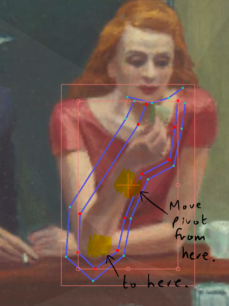

Is it possible to move the origin on a point selection? Thanks.

Almost what I was after, but not quite, unfortunately. It only selects some of the points close to where you click, not all of them. An example of what I want to is take a photograph and triangulate a mesh on an arm and move the pivot point to the elbow.

No no, the tool doesn't select any points. You manually select the points you want to transform (in this case, your arm) then you use the shortcuts that you can read on the tool bar hovering over the target icon. Alt+click that icon to put the pivot in the center of the selected points, and shift + alt + click on any place of the screen to move the pivot there like you want. You will see how the cross moves to that location and you can rotate your arm and live happily ever after.

Aha! Brilliant Daxel, I didn't realise you had to shift-alt-click, and I was just clicking. That does the job nicely. Thanks again. :D
