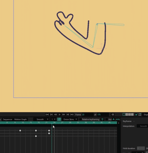

hope it's okay if i hijack this thread! vitruvian bones aren't crashing for me in 13.5.3, however, i am getting this strange timeline flickering whenever i enable onion skins. just wanted to see if anyone else has come across this? strangely enough, i don't get any flickering when experimenting with the included vitruvian man project files in the library...

Ok, I'm not having any issue with your file here on Windows 10 using 13.5.3
Now, and maybe this is related to what you are seeing, the timeline works in a special way with this bones.
If you a vitruvian bone is visible on the frame your are at that moment, you will see all the keyframes of that vitruvian bone in the timeline.
If you go to a different frame on which a different vitruvian bone is visible, then you will see the keyframes of that other vitruvian bone.
So, in your file, you can try this:
- Go to frame 17
- You will see the keyframes of the vitruvian bone B4
- Now move the arrow left to go to frame 16
- You will see the keyframes of the vitruvian bone B2
- If you use the arrows to move the cursor from 16 to 17 and back to 16
- You will see the timeline keyframes changing every time
(This behavior is especially visible when you use the arrow keys on the keyboard. If, instead, you drag the mouse to go to a different frame, then the timeline will be updated only when you release the mouse)
That's one of the reasons we have the special "Vitruvian Bones Consolidated" channel. That channel shows you if any of the bones, visible or not visible at the moment, have keyframes at any momemnt.
Posts: 10280
Re: Vitruvian Bones Crashing
I can verify that behavior:
It seems the onionskin is conflicting with the Vitruvian bones. So when the onionskin tries to show a v-bone not showing on the current frame, it can flicker like that.
