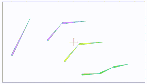

This problem is driving me nuts, and I'm probably missing something obvious... I'm hoping anyone can take a look and point me in the right direction.
When you drag a bone in a FK chain, it will rotate and scale it's parentbone as if it were IK. And rotate the selected bone as if its angle was independent. As you see in the GIF, when the parentbone that's being adjusted has a parentbone with an angle that's not 0 degrees the mouse is offset and the tool is broken.
The tool also works for entire chains if you set 'local singleMode = true' to false and drag a bone in a chain of multiple parents that are not set to ignore IK. But the problem doesn't happen in that case because it uses Mike's IKSolver function.
See code below GIF. The tool is dependant on FO_Utilities. Here's the testfile from the GIF: testfile

Posts: 10574
Re: Need help with mouse offset in a tool
Tried using on the keyed frame and immediately got an error for line 126, invalid operand.
You need self.skel on line 86.

synthsin75 wrote: ↑Sat Jul 09, 2022 11:07 am Tried using on the keyed frame and immediately got an error for line 126, invalid operand.
Ah, thanks, there was another tool that had set the skeleton globally.
hayasidist wrote: ↑Sat Jul 09, 2022 12:58 pmThere might be some nuggets in there to help
Ha! Thank god for annotated code. Your "-- ** bone fPos is relative to parent's position and rotation unless no parent, in which case it's absolute" comment made something click. I had to rotate a vector before calculating the angle:
Code: Select all
-- * Calculate angle:
			local v2 = LM.Vector2:new_local()
			v2:Set(fakeTargetVec.x - parentBonePos.x, fakeTargetVec.y - parentBonePos.y)
			local grandParentBone = self.skel:Bone(parentBone.fParent)
			if grandParentBone ~= nil then
				v2:Rotate(-grandParentBone.fAngle)
			end
			newAngle = math.atan2(v2.y, v2.x)
One step closer to what I need! Thanks!
Now I need to figure out what angle to rotate it with, because using the grapdparentbone obviously doesn't work for a longer bone chain...
