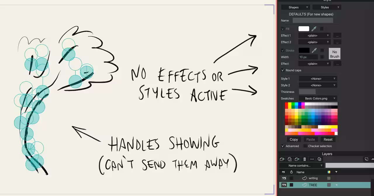

Here's a screenshot of the situation. New strokes on that layer will also "think" they have textures in them and display the handle.

Here is a screenshot showing the texture (or gradient) handle showing regardless of no active style or effect. These strokes "carry" the visible handles even when I copy them into a new file.

This is a screenshot of what happens: gradient (or, maybe Image Texture) handles are "stuck", meaning they won't go away regardless of there being no active styles or effects. As one can see, the strokes are selected with Shape Selection, so "plain" or "none" in the effects and style dropdown menus should make the handles go away.
Unless I'm doing something wrong this looks like a bug. I can share the file (BTW, the strokes reproduce this problem even when copied to a new file).

What the style panel is showing in your image is not the properties of those shapes, but the DEFAULTS properties (for new shapes).
For she style panel to show the properties of a shape, the shape must be selected and then the style panel will say SHAPE, instead of DEFAULTS.

Daxel wrote: ↑Wed May 08, 2024 1:40 am What the style panel is showing in your image is not the properties of those shapes, but the DEFAULTS properties (for new shapes).
This happens even with one shape selected. The Effect 1 (for fills) says there's an image texture somewhere but is greyed out so I can't tell it to be "plain"

Reindeer wrote: ↑Wed May 08, 2024 2:09 am
But now the panel is displaying the actual shape properties and we can see that you are not doing anything wrong, something is clearly not working well there and a bug report makes sense.
