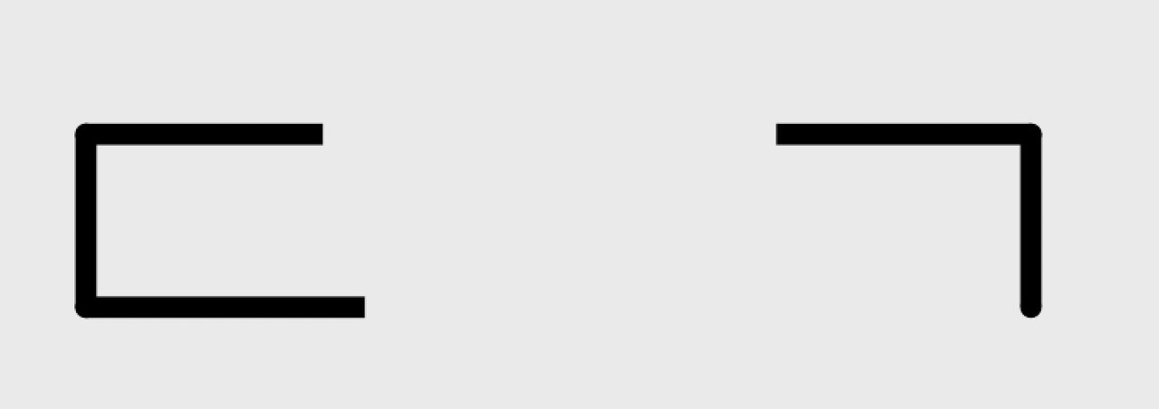

Here's a test on my end. This is a render cause you're right, in viewport it's a hit or miss, but most often rounded whether the checkbox is ticked or not.
On this render it's flat, except for the lower right corner of that rectangle.
I really wish they fixed that in a future release. Vector tools are pretty good in Moho otherwise, it would become my go-to vector software if it wasn't for this.
And also impossible to get sharp corners
