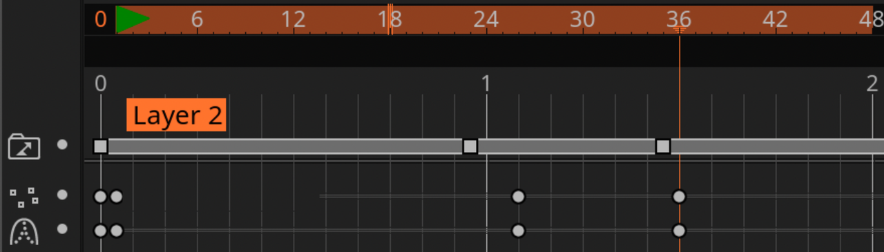

To update it here too:
The most ideal situation for me would be if we could just see the point animation and frame changing at a glance. I don't mind not having the separate layers visible in the layer window but if we had basically the fbf switch and then the point channels underneath (they correspond to the different, active children of the fbf layer) that would be so SO much of a workflow improvement and would reduce layers needed significantly for a lot of cases...

Re: Let us tween points on FBF layers
can be done with a layerscript -- embed this in the switch layer
If I get time over the summer, I'll add this to the fbf toggle and have it auto install itself. In the meantime...
Code: Select all
function LayerScript(moho)
local layer = moho:LayerAsSwitch(moho.layer)
if layer:IsFBFLayer() then
local drawLayer = moho.drawingLayer
local i
for i = 0, layer:CountLayers()-1 do
layer:Layer(i):SetShownOnTimeline(layer:Layer(i)== drawLayer)
end
end
end
Thank you hayasidist, really appreciate all your efforthayasidist wrote: ↑Tue Jul 09, 2024 1:43 pm can be done with a layerscript -- embed this in the switch layer
If I get time over the summer, I'll add this to the fbf toggle and have it auto install itself. In the meantime...Code: Select all
function LayerScript(moho) local layer = moho:LayerAsSwitch(moho.layer) if layer:IsFBFLayer() then local drawLayer = moho.drawingLayer local i for i = 0, layer:CountLayers()-1 do layer:Layer(i):SetShownOnTimeline(layer:Layer(i)== drawLayer) end end end
