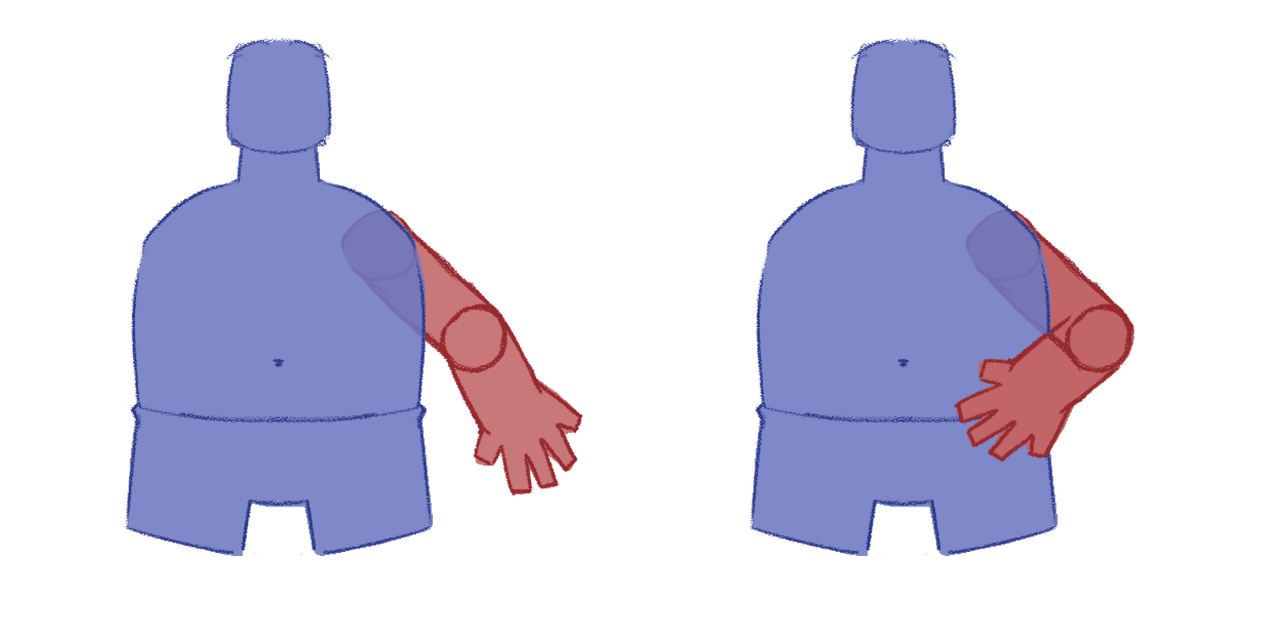

How does one approach this in Moho?
Specifically if upper and lower arm are not seperated?
Is there ans way to patch if needed or move the hand part in Z space?

There are many ways to do this. For your example, I'd draw the arm as a single item divided into two shapes that appear as a single seamless shape...
This is done by hiding the 'border' line segment at the elbow using the Hide Edge tool. Here's an image showing the elbow edge hidden. (Fills in Display Preview have been disabled to make the setup more obvious)...
Then, I duplicate the layer and knock out the shape in the upper section for one layer and the lower section in the other layer. I also add a single point to the 'border' line in one layer and drag it across the border. This helps hide the seam that can appear in an anti-aliased final render.
(In the above example, the edge-overlap is in the upper arm layer. Typically, it doesn't matter which layer has this overlap, but it could matter for some character designs. Use your judgment.)
Next, I create reference layers for both layers and move them behind the torso, so we have one complete arm set in front and one behind. This allows me to hide and reveal the sections of the arm to create the appearance of the arm 'wrapping' around the body. (Actually, I created duplicate layers in this example, not reference layers, but reference layers typically make sense when editing the original. I often break the arm references for my final 'master' rig, though, to avoid possible issues when the character rig is referenced in a scene project.)
Finally, a Smart Bone Dial is created to control the visibility of the layers.
Here's the above setup animated...

I just realized my example animation with the blue guy doesn't show the shoulder going behind the body, but it is possible with this rig. To do this, I hide the foreground copy of the upper arm (armUp Near) and show the background copy (armUp Far).
To hide the layers in the rig, use the Visibility switch in the Layer Settings; don't use Transparency. Animating Visibility is cleaner and less CPU-intensive.
Tip: it's not necessary to enable Animated Effects to keyframe Visibility. Visibility is one of the few options in the panel that doesn't require it.

Thanks for this profound answer Greenlaw! Very helpful!
The method described first seems to work well and might be quick to setup when needed.
