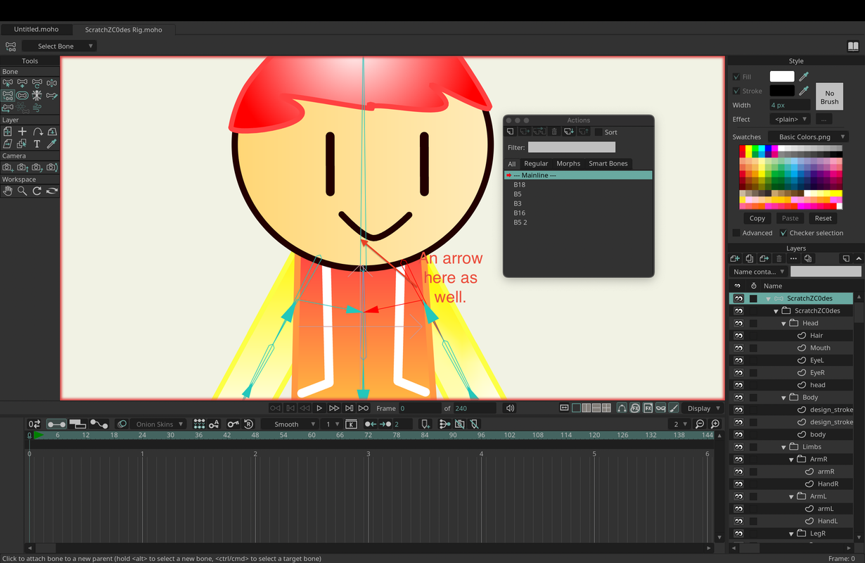

Thanks for responding :D. Here's what I actually mean:
I'm trying to achieve this so that the head can move the arm, and so can the body (if that's even possible)
Posts: 6361
Re: Can I parent a bone to 2 other bones?
Hm. For me that looks like tilting the head should move the shoulder and thus the arm. I'd do this:
- create a clavicula (collarbone) bone attached to the body, right under the head and horizontally outside
- bind the arm bone to that (I'd place the anchor point deeper and more outside)
- and let the collarbone be angle controlled by the head bone.
Posts: 10841
I would just move the head bone up so its base is at the shoulder line. It doesn't need to be visibly connected to the body to rotate from there, and it will still move with the upper body bone. A lot of the characters I've animated in Moho don't have necks, and this is pretty much how they were set up.

Posts: 10841
If I understand what you're trying to do, then I agree with slowtiger's suggestion. I often have bones that have no strength and exist solely as movers and pivot offsets for another bone or groups of bones.
The clavicle bone he describes is a good one, but many of my 'offset' bones are functional for what I need for the character and may not resemble the bones in a biological human skeleton. I would experiment with these thoughts in mind.

How would this, clavicula bone look like? I just wanna be sure that what I'm thinking is how it should actually be. Maybe an image/demonstration could help me visualize this better and help me know what to actually do?

So those bones on the bottom of the head bone will stick out for each arm? Do I just bind the top vector points to them or the entire arm? Quite hard to really know exactly what to do without any explanation. I think I know what to do, but I'm just not sure. Sorry :(
