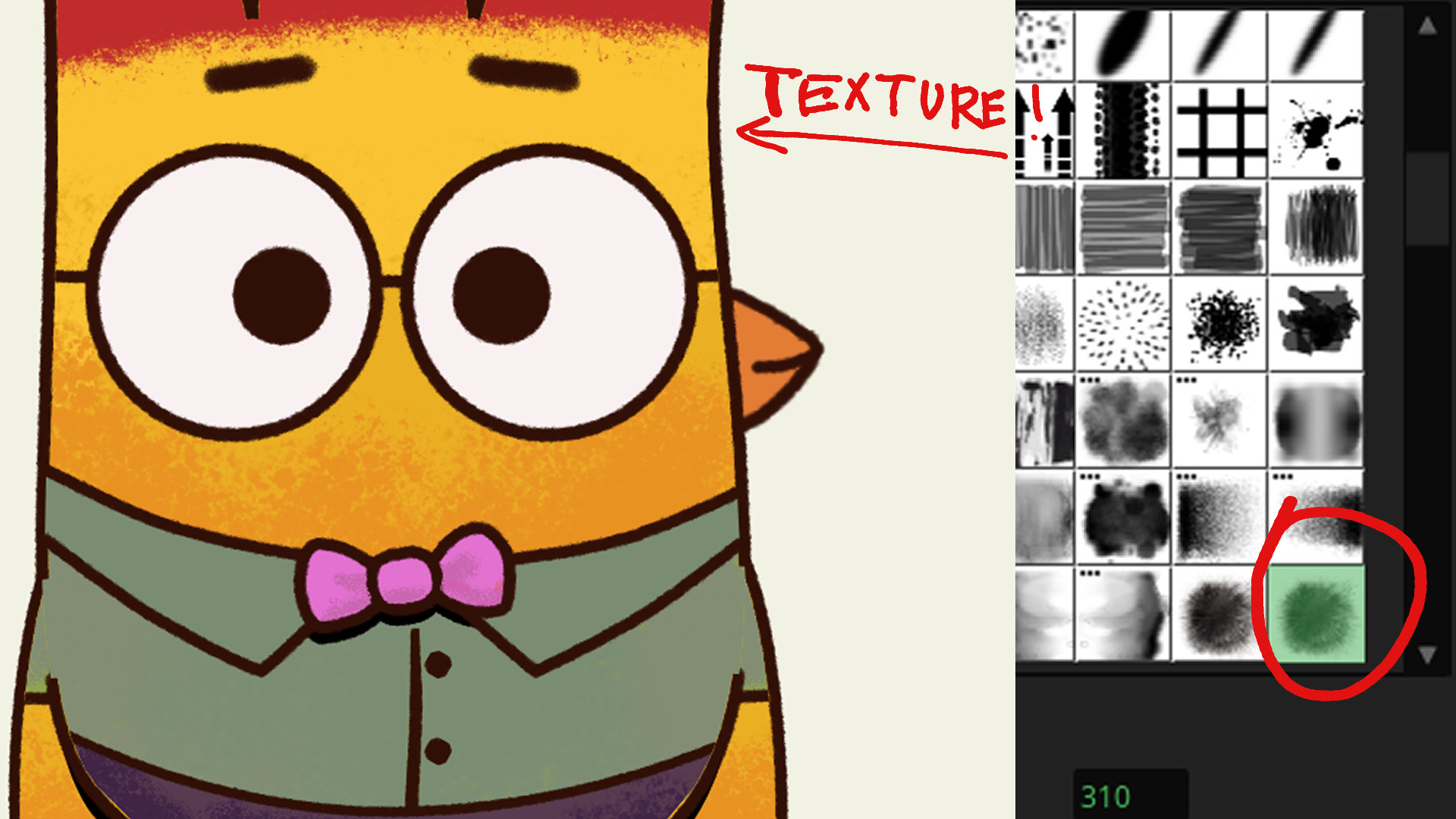

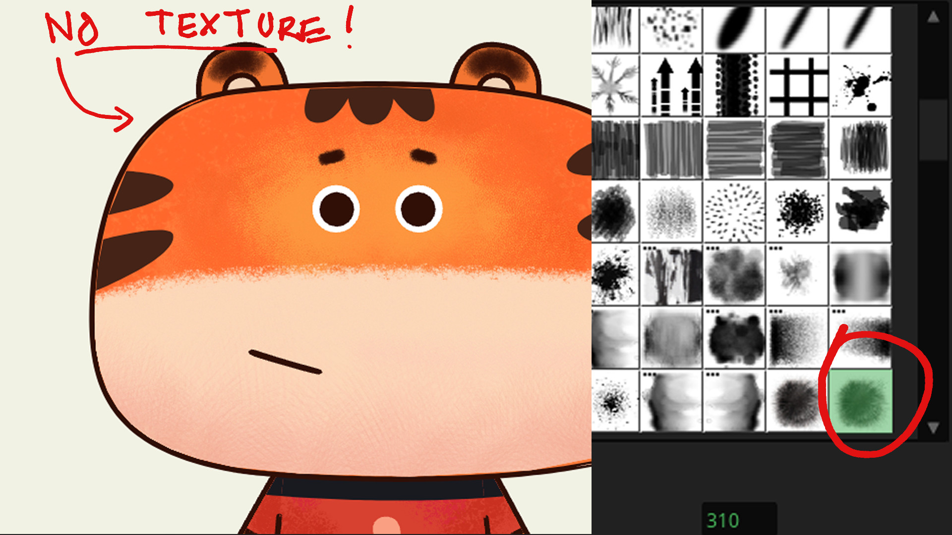

Hello, I am Using a custom brush stoke for all my characters.and have been animating using the same device. Recently i switched to a newer device but when i opened the files all the custom strokes were gone as the custom brush was not loaded into moho.But even after multiple times of loading the brushes into moho.it doesnt seem to update the strokes .
You can see one image is from my older device,the one with the tiger character is from a newer device.both devices have the same custom brush loaded in the brush panel but the newer version is not updating it in the rigged files.
Now i have to manually change all the strokes and apply the custom brush but is there any other way to make my life easier.

It's hard to know what is going on with the amount of information on the screenshots, but I'll try to guess.
- Are you sure the brush is not being applied? Could you try selecting the brush and modifying the values? Maybe the brush is there, but the spacing is too low.
- Are the brushes appearing when you render? Maybe the preview is not working correctly here?
- Are the brushes active in the Quick settings of the layer?
- Are the brushes correctly installed in the custom folder?
Maybe not one of these options will help you. In that case, is there any chance for you to share the .moho file and brush?
