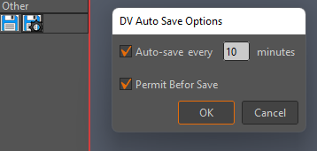

Sorry, maybe I pointed you to the wrong one. Here's a version of Davoodice's script with the auto-save mode, which saves in the background at a user-defined time interval...
I don't use this script, so I'm unsure how to access the timer box. Looking at the picture, I'm guessing you click the button with the gear. I'm also guessing that unchecking Permit makes it fully automated. If that doesn't work, you could ask Davodice about it.
