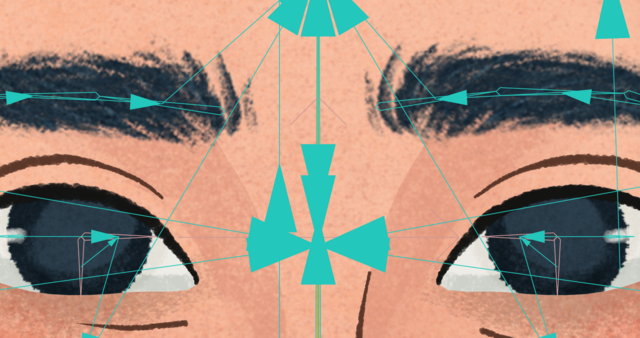

Hi everyone! I'm pretty new to Moho . :oops:
I haven’t been able to find much info or tutorials on this, so I thought I’d make a post and ask here. Really appreciate your time and any help you can offer!
So, I’m wondering — is there a way to make the parent arrows on bones smaller, or only show the parent arrows for the bone I have selected?
When I’m working on more complex rigging, the parent arrows sometimes get in the way and block the bones I’m trying to click on. It gets a bit tricky to work with.
I’ve tried using the “Toggle Color Bones” script to hide the bones I don’t need, but their parent arrows still show up even when the bones are hidden.
Just wondering how you all deal with this?
Would love to hear any tips or workarounds. Thanks so much in advance!
Image "There are arrows all over the place!" :x
Posts: 6371
Re: only show the parent arrows for the selected bone?
You can keep any bone invisible by making it a shy bone (and reverse that, of course). This is useful f you have a rig with many small bones cluttering your view.
Posts: 3990
slowtiger wrote: Thu May 22, 2025 1:50 am You can keep any bone invisible by making it a shy bone (and reverse that, of course). This is useful f you have a rig with many small bones cluttering your view.
I think that just hides the bone, not the parenting arrows? (same as hiding coloured bones).

Thanks so much for all the replies!
You're right — when using the Shy Bone tool to hide bones, as soon as I switch to the Reparent Bone tool, all the parent arrows still show up — including those from the hidden bones. It really gets in the way and makes things difficult. :cry:
I’m also wondering — is there a tool or option that lets me choose the parent bone from a menu or list, instead of clicking directly in the viewport? :?:
Because right now, the arrows are covering so many bones that I can’t clearly see or select the one I want. :x
Posts: 10462
A quick mod of the reparent bone tool:

This will only show the arrow of the selected bone and its parent bone.
