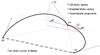

I have an idea about how to put full cubic Bezier curve support into Moho, keeping the Curvature conception and all existing algorythms. Usage of Bezier has many advantages over the Moho curves, for example the perfect implementation of the fonts, .ai and .eps files. But it is good if you can keep the curvature and the easy handling of points.
Bezier uses 2 control points for all of the internal points on the curve. In 2D, it means 4 independent numerical parameters at all internal points (2 at the open ends of the curve). Moho is using cubic Bezier curves, but calculated from only one parameter, the "Curvature" (see my topic at Scripting: http://www.lostmarble.com/forum/viewtopic.php?t=4462).
What if you add 3 new parameters to this system at each points, keeping the Curvature, to fully match with cubic Bezier curves? The control points are calculated in Moho on a line, parallel with the line between the two neighbouring points of the actual point. Currently the distance of the control point (from the actual point, P1) is the distance of the neighbouring point (P0 or P2), multiplied by the Curvature:
(I mark the vector values with a beginning _underscore)
_M1= _P1 + Mag(_P1 - _P0) * _Norm(_P1 - _P2) * Curvature
_M2= _P1 - Mag(_P2 - _P0) * _Norm(_P1 - _P2) * Curvature
You can modify this with an independent Weight value:
_c1= _P1 + Mag(_P1 - _P0) * _Norm(_P1 - _P2) * Curvature * Weight
_c2= _P1 - Mag(_P2 - _P0) * _Norm(_P1 - _P2) * Curvature * (2.0 - Weight)
Default value for Weight is 1.0.
If the Weight is 1.0, this calculation is exactly the same as what Moho is using now.
To put the control points outside of the line, anywhere on the 2D space, you need two additional, perpendicular parameters. These could be, for example PCurvature and PWeight, working in the same way as Curvature and Weight:
_T1= perpendicular vector (y, -x) of Mag(_P1 - _P0) * Norm(_P1 - _P2)
_T2= perpendicular vector (y, -x) of Mag(_P2 - _P0) * Norm(_P1 - _P2)
_C1= _c1 + _T1 * PCurvature * PWeight
_C2= _c2 + _T2 * PCurvature * (2.0 - PWeight)
Default value for PCurvature is 0.0, for PWeight is 1.0.
In this case the calculation is exactly the same as what Moho is using now.
So if Weight= 1.0, and PCurvature= 0.0, you can use the old algorythms (even users' Lua files), file formats etc. But if you use these things correctly, you will get FULL CUBIC BEZIER SUPPORT. This solution is not redundant and fully compatible with the old system.
The only problem if any two of P0, P1, P2 are equal, this must be tested and processed (translating a point with a very-very small vector).
Now I'm making a Lua toy to try this, how these things are behaving when the points are moving.

Now I wrote a Lua language script toy to try this conception. It seems you edit Bezier curves, but really it works with the Curvature, Weight, PCurvature, PWeight values. Now it seems working, but the PCurvature and PWeight are not quite stable if the points are moving. That's a problem so I am thinking on a different, but also easily computable solution. LM's original Curvature is genial because it is quite stable during the usual transformations like scaling or shearing, and not easy to extend it to full Bezier support while keeping its stability.
Download, copy to the scripts/tool folder and try it:

I am working on something to convert curves (typically defined by a sequence of linear segments) into Moho curves. You can see my another 'toy' at the Scripts section about this. But in this topic I try to show how LM could expand the existing curves to be compatible with the cubic Bezier curves. For cubic Bezier curves, there are many freely available algorythms and even shared libraries so Moho could have brighter future if they do this step (I hope only the name will change).
I'm happy if you like this toy but now I'm thinking on a modified version. Now there are two curvature values, one as the original and another for the perpendicular components. The other problem is that the existing Moho curves are working perfectly if you, for example streching the shape. So now I find a solution for these:
- to use only one "Curvature" value,
- to be as friendly to usual transformations as possible,
- keep the compatibility with cubic Bezier as much as possible.
To solve the Curvature problem, it is easy if I add the actual two vectors together before normalizing and multiplying with the Curvature. In my solution, there is a vector between the two neighbouring points, P0 and P2. Additonally, I am using the same vector, rotated by 90 degrees for the "perpendicular" components. Instead of this, I could use a second vector between the actual (P1) point and the bisecting (P0 + P2)/2 point of the two neighbours. It is behaving well in the transformations, but in some special cases it is not compatible with the cubic Bezier curves, so now I'm still searching the solution.

My new idea, mathematically:
_T1= Norm( _P1 - _P2 + (_P0 - (_P1 + _P2) / 2.0) * PLift )
_T2= Norm( _P1 - _P2 + (_P0 - (_P1 + _P2) / 2.0) * NLift )
This is the addition of Moho's original vector and a weighted "bisecting" vector. The weights, both PLift and NLift are 0 by default.
_C1= _T1 * Curvature * Weight (+_P1)
_C2= _T2 * Curvature * (2.0 - Weight) (+_P1)
The Curvature is the original Moho Curvature and Weight is similar to my first version's Weight (default to 1.0).
I made a toy for this new calculation style, similar to the first one, it is working very good - I think -, except for the endpoints of an open curve, since the "bisecting" vector is a null vector there. That's why I used the "perpendicular" vector of the first version at these points.
ADDED: A correction: the "bisecting" vector is not (0,0), only parallel to the Moho's original, so it is not possible to create a vector outside of Moho's original line. - Fazek

In this version, it is a problem if the "bisecting" vector has no perpendicular component to the original LM's vector (linearly dependent). It is the case if the points are collinear and at the ends of open curves. In this case, it is not possible to move the C1,C2 points outside of the line. This is a hard problem and I don't know yet how to make a solution. And this feature is required if you scale the shape in one direction into a single line. So it is not possible to emulate all of the possible Bezier curves, only a subset of them.
I think a few experiments needed to find the perfect solution, and until that, I don't recommend LM to include this into Moho. Maybe there is no perfect solution and it is better to keep the existing system. But in that case, we can use these experiments to create a perfect emulation of Bezier curves. It is required to implement .ai and .eps files, and the fonts correctly. Perhaps we can use one or more virtual systems to manipulate the curves, with other kinds of handles, etc.
I think the best advantage of the cubic Bezier curves is that there are a lot of existing algorythms to manipulate these curves. So it MUST BE in Moho somehow!
