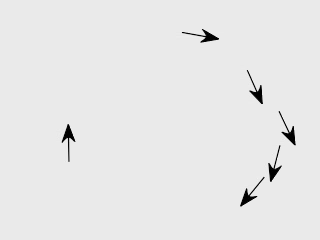

Quick tutorial for third example:
1) Create a shape (an arrow) make it point to the Y axis (pointing up)
2) Using Translate layer tool move it by a path. For example I used 31 frames to do it. There is a translate keyframe at frame 31.
3) Check in the "rotate to follow path" in the layer dialog options. I have no idea why at frame 31 in my case the layer doesn't follow the path (almost the last path!). It should look like this:

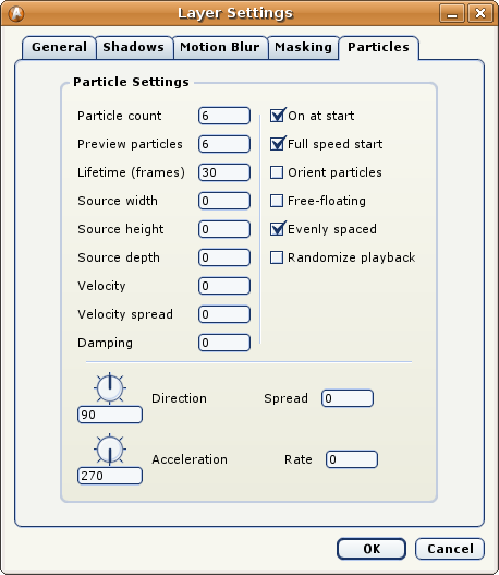

4) Place the vector layer inside a particle layer and set the values for the particle layer like this:
In the example the particles life was set to 30 (one frame less) due to the lack of orientation of the layer once the path is finished. Anyway you can make the path longer.
Also the particle count is a taste of the user. Place more or less depending or your preferences.
You'll obtain this:
Notice that the speed is high at the beginning. It is due to the animation of the layer translation. Nothing related to particle layer.
