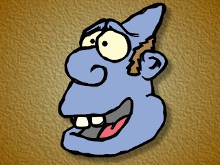

There is a way to achieve some effects like bump mapping. Let's start with this scene in Moho:

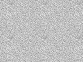

Then, add this texture image as an image layer on top of everything else in the scene:

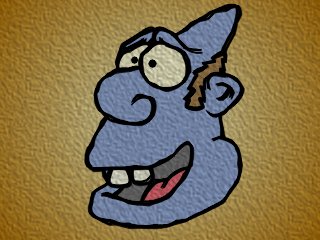

Set the new image layer's blend mode to multiply, and you get this:
Or, move the image layer down so that it is above the background, but below the head and you get this (with a layer shadow added to the head layer):
The texture image was created in Photoshop. Using this technique, you can create all kinds of "lighting effects" by just adding light and dark areas to the texture image.
